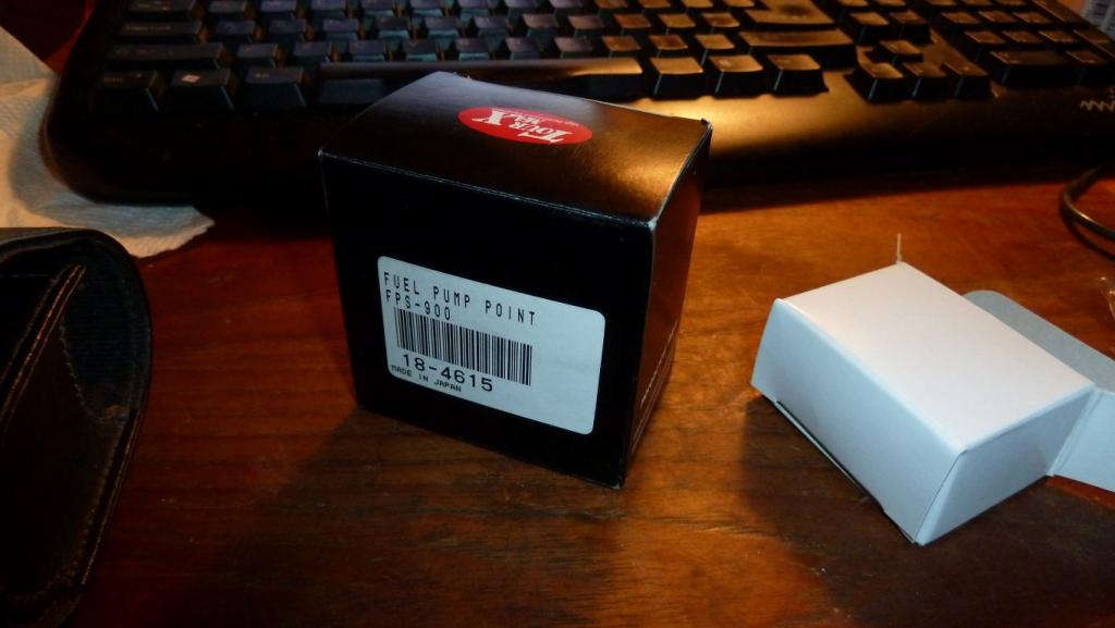

Bert2006 Posted June 22, 2015 Posted June 22, 2015 I took the pump apart. I have no idea where or how you guys are getting or replacing the points. Calling the stealer today to get a price on an OEM. Going to go from there. See this thread - there is also a video showing the points. http://www.venturerider.org/forum/showthread.php?104162-Fuel-Pump-Points&highlight=fuel+pump And here is video on how to replace the points: https://www.youtube.com/watch?v=1gYH7EVbM8Y
rickardracing Posted June 22, 2015 Author Posted June 22, 2015 Bert, thanx I will check this out. Joe, thank you too. I may buy a new one and either buy the kit to replace the points and throw the repaired pump in the saddle bag as a "just in case" while on the road.

Condor Posted June 22, 2015 Posted June 22, 2015 (edited) I took the pump apart. I have no idea where or how you guys are getting or replacing the points. Calling the stealer today to get a price on an OEM. Going to go from there. FUEL PUMP POINTS Edited June 22, 2015 by Condor

rickardracing Posted June 23, 2015 Author Posted June 23, 2015 I ordered the direct OEM replacement from Dennis Kirk. And I ordered one from Caltric off of ebay for a whopping $23. That one listed on their website for between 40-55 bucks. Got the ebay special. When that comes in, I am going to make sure it works and then stick it in the saddle bag as an onroad back up. I will install the OEM as a full time replacement. I do not like the idea of replumbing something. I do not feel that added work is necessary, there are other options available. The original lasted 48,000 miles. The OEM is manufactured by the same company that built them for Yammie. Keep a cheap spare or even a the original that is rebuilt in the bags and if the replacement goes out, it is literally a 15 minute fix. No messing around with fittings and homemade brackets. Take the stock bracket off, put it on the new pump, hook up the lines, mount to the original holes, plug it in and go. Thank you to all that replied. Condor, I maybe ordering the points rebuild kit. Thank you also.
