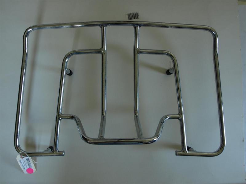

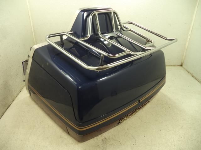

The Goldwing racks are pretty much useless because of the way they are shaped with that high rise in the center. Makes it impossible to lay anything flat on the rack. Excellent advice above on installation.
Perhaps that is true for certain racks intended for the GL, but the ShowChrome rack that I had was for a 1988-2000 GL1500, and it fit and worked nicely on @Semi-retired Second Gen.

From the "For what it's worth department" I installed a HD rack on my RSV without any issues. It does sit at a slight angle (in line with the trunk profile) but is perfectly suited for the intended purpose and having found an NOS one purchased at a greatly reduced price.
