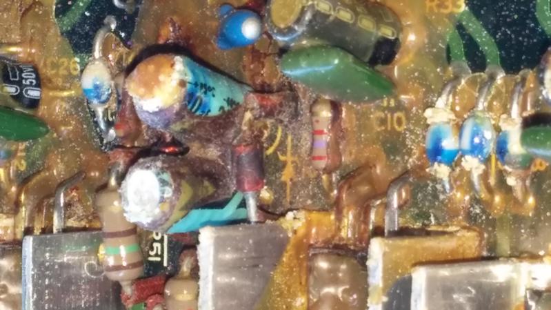

OK.. 16 months later and I am back to the '83. Plugs are now firing 1 and 3 only. No spark on 2 & 4. I have opened up TCI and it looks bad (see pic). I checked the diodes with my Harbor Freight multimeter and believe it or not they all seem to be OK! However, as you can see in the pictures, a couple (or more) of the capacitors? are corroded on top. Also I re-soldered the connectors. Coils and pickups check OK.
It looks like I will be quadrupling my investment soon!
My problem is how to obtain a replacement TCI. I haven't seen any posts from Dingy in the last few months, so I guess he is not selling the Ignitec anymore.
Anybody have a known good 83 TCI for sale or loan? (I would pay deposit). I can also use 83-89 and modify vacuum port.
Has anyone purchased a Ignitec direct from factory and if so, how much and are you happy with it? What was the delivery time?
Thanks!! I couldn't tackle this without help from forum members.
