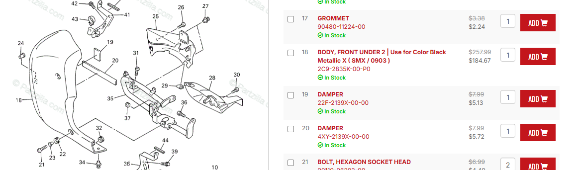

does anyone now of a good salvage yard to get parts from. pinwall is now closed, sold out. been deal'n with suncoast out of florida' but they don't have the last 2 parts i need to finish put'n the bike back together. been on the computer go'n threw the sites i could find. got the last 2 parts ordered from mother yamaha, but the one part is back ordered for 2 months. was hop'n to have the bike fixed before then. get'n the itch to ride again! i need the front right crash bar and the front right lower cowling. hope you all have a wonerful day n ride safe!!!
