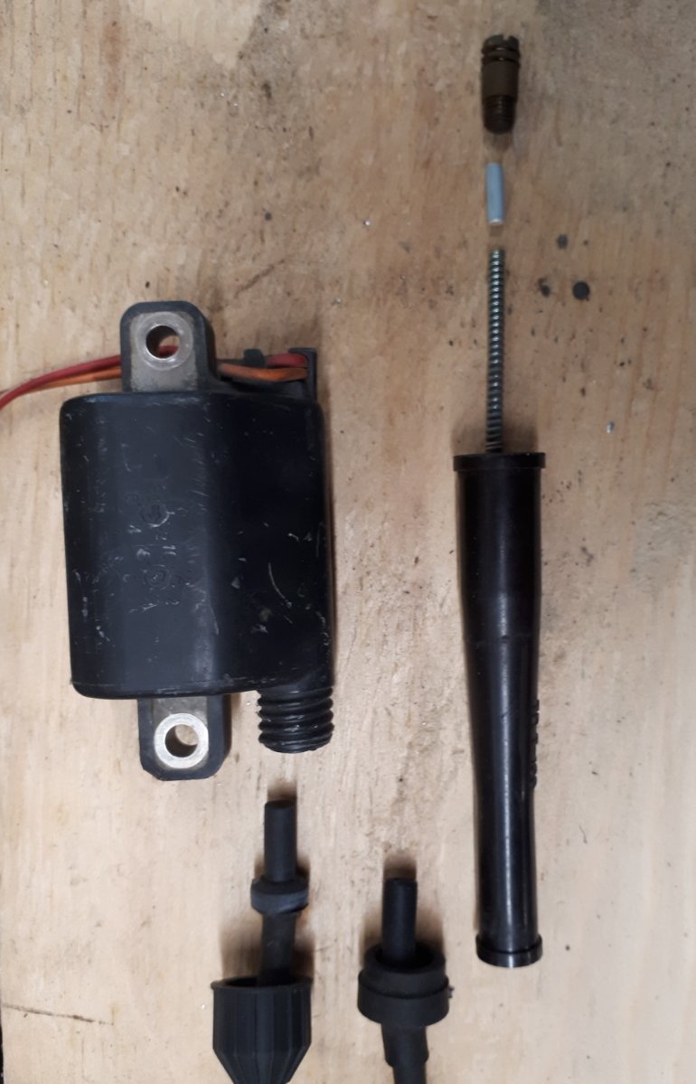

saddlebum Posted July 2, 2021 Share #54 Posted July 2, 2021 32 minutes ago, Squidley said: It's locked in with that plastic nut, there's an oring in there that acts like a compression fitting when the nut is tightened if memory serves me right. Your are correct . though the wire threads into the plug boot it only pushes straight in to the coil and then held in place with the rubber grommet and nut. I also mentioned earlier about inspecting the removable parts of the plug boot. here is a pic of all pulled apart. 2 Link to comment Share on other sites More sharing options...
Squidley Posted July 2, 2021 Share #55 Posted July 2, 2021 (edited) The green plug appears to have been something for the California models. None of the 1st gens I've ever owned have been hooked to anything. Edited July 4, 2021 by Squidley 1 Link to comment Share on other sites More sharing options...

Marcarl Posted July 4, 2021 Share #66 Posted July 4, 2021 On 7/2/2021 at 10:43 AM, Squidley said: It's locked in with that plastic nut, there's an oring in there that acts like a compression fitting when the nut is tightened if memory serves me right. Your memery is not so bad yet, keep up the learnen!! 1 Link to comment Share on other sites More sharing options...
