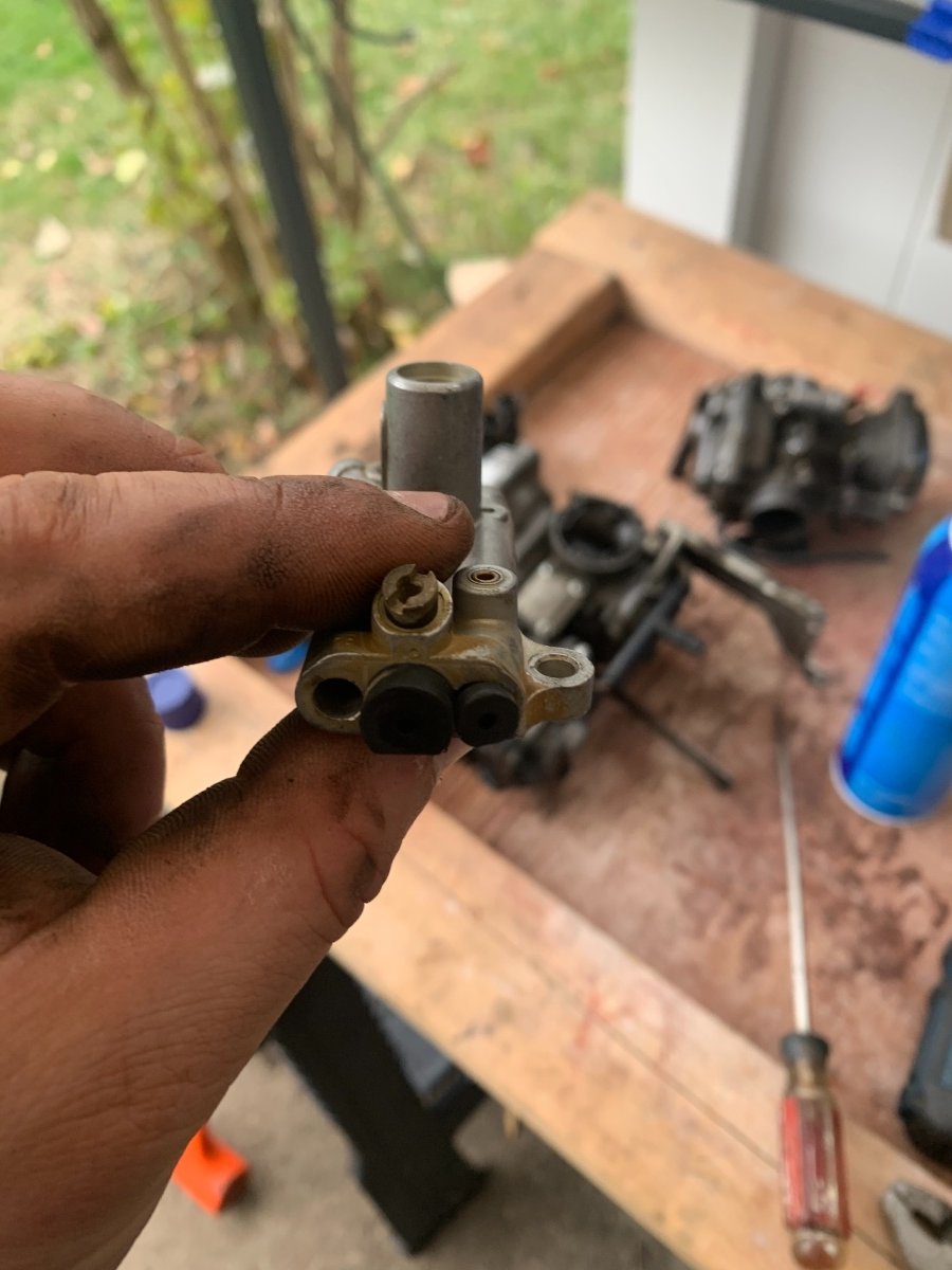

Hello all; my name is Jon. I have a newly acquired 1983 Yamaha venture 1200 xvz. So to try to explain what I have done here to get myself into the predicament that I am now in...... this is going to be to say the very least embarrassing for me. But the inner auto technician in me wants the damn machine running. Well I purchased this bike hadn’t run in probably a decade or better. That being said I figured need the carbs throughly cleaned..... duh! Well anyways I did pull the carbs off and cleaned out the jet block; that was a new one for me; I currently have a 1982 Yamaha Maxim 650 that I got running from a worse state of being hence my embarrassment. That being said this machine is a completely different animal. Well that being said each I reinstalled the carbs and ..... still not much it would start but stumbles each time I pull the throttle granted this is cold and needs the choke but I thought I could do this with my XJ and my Harley surely this can too.... not so much again I freely admit totally different monster than I am used to. So fast track I finally got the bike to run a bit and got the throttle to respond sorta decently. So I replaced the spark plugs and checked for spark and it was there. I figure still an engine gotta have air; fuel and spark...... anyhow did that changed all four. Bike fired up pretty nicely they were the NGL fine wire iridium for nearly $8 a piece. Did that put the fuel and intake back together and rode it to my in-laws less than a mile away. Noticed immediately that it had a major bog down over 1700 rpm. So much so that I could up shift and engine really didn’t respond to more throttle just stumbled and kept going in its stumble. Fast track couple of weeks later I thought I must have done something wrong on the carbs because I noticed a fuel leak from carb number 4 passenger side front or right front carb. So I took it all apart to look and notice when I cleaned the jet blocks apart I swapped all the bowls around to the wrong spot to the vent tubes faced forward toward the headlight. Then tried starting after being reinstalled with the aide of my beautiful bride small hands; she hates when I say it need it was a “small hand job” but I have far snausages from working on cars and trucks all day. Anyhow she got the throttle return cable hooked to the inner right connection of the carb setup and of course I got the main throttle cable hooked up to the furthest outer and then the choke to the furthest rear connector on the left side behind the carb rack in front of the gas tank. Alright fast forward I had the carbs exposed no intake and tried the choke and no throttle and bike wouldn’t catch. Would the the catch and hiccup and backfire really really liked the back fire which should have been a really good indicator to not do what I did next. Mind you this is without the carb bowl vent tubes connected and routed under tank. I started spraying starting fluid..... stupid I know very stupid especially with the backfiring but I digress. Got it to fire and then stall and a nice mondo humongous back fire then whoosh all of sudden I have an active flame on top of my carb rack and it’s growing. Oh crap not good my wife understandably freaked out called the fire dept.... which I got lucky and put it out before they dispatched the truck but holy crap way too close! Anyhow going from that point to I think I need some serious divine knowledge to be reigned down here!! Please help I will not take things stated offensively assuming they’re going to be constructive also I am expecting to make a giant to do list on systems to check out and clean up.

First: the CV carbs on the Venture will not perform well with an open intake. The airbox and filter must be fully installed. Closed up.
Second: if the jet block was cruddy, it is likely that the pilot circuits within the carb body are fouled, too. The pilot jet is notorious for being easily blocked.
I suggest that you need to perform a THOROUGH re-cleaning of the carbs, replacing gaskets and O-rings with new.
Attached is a pdf file for an excellent tutorial on cleaning the Mikuni BDS carbs.

Now I am curious as far as what the rubber plugs do on the jet block? But my pilot circuit was very clean on the carburetor and the enrichment well also. And also yes I swapped them around referring to the rubber plugs. The smaller one goes into the pilot circuit and middle one takes the larger of the two or atleast according to the VMAX carburetor cleaning guide that was on the pdf from the forum. I reset my float bowl fuel levels according to the guide. And I also set the air/fuel ratio screws from bottom 2 full turns out each. I am hoping that whatever was causing the problem for the venture came out during this cleaning. I am also planning on removing the spark plugs to make sure the engine is storing excess fuel. Not likely but still worth making sure.

The rubber plugs actually seal the bottom of the passageway and prevent the block from sucking gas out of the float bowl. They should fit nice and tight and not be loose at all and if they are loose, they need to be replaced.

What if these plugs were in the incorrect location ? It appeared that the small plug was supposed to be on the pilot circuit. Would this cause an idle problem or rather a no start problem?
