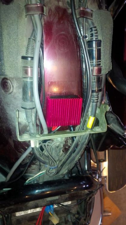

M61A1MECH Posted December 16, 2015 Share #10 Posted December 16, 2015 So here is what a fellow over on the Stratoliner forum did. He bought one of my break out harnesses and connected his load resistors from the turn signal break outs and then took the other side too the ground wire. Worked out well and no wire cutting or splicing on the bike's harness and you have tag wires for extra brake lights or tail lights. here is link for a Venture set up. http://www.venturerider.org/forum/photopost/showproduct.php?product=4&title=aux-lighting-harness-for-2nd-gen-venture&cat=18 Link to comment Share on other sites More sharing options...
Flyinfool Posted December 16, 2015 Share #11 Posted December 16, 2015 Whether you need 2 or 4 resistors (load equalizers), depends on what resistor values you use. Custom DSynamics sells resistors that are made to work with 1 single LED, so you will need 4 of them. The CD resistors are 6 ohm 25W each. The resistors that I recommended will need just 1 resistor per side of the bike and will give proper load for 2 LED bulbs. The ones I used are 3.3 ohm 50W each. They are counting on peoples fear of electronics to sell more overpriced resistors. Using the breakout connector is a great Idea. Link to comment Share on other sites More sharing options...

ToyOdie Posted December 16, 2015 Share #13 Posted December 16, 2015 When I decided to change to LED turn signals on my 96 RSTC, I went with the Custom Dynamics LED signals and Kuryaken run/stop/turn (PN 4710 Universal Run-Turn-Brake Controller). I also changed the rear lenses to red and installed the Custom Dynamics LED brake light. Installing the unit was simple however, I couldn't get the front to work properly. When you turned either one on, they would both go out. I ordered the resister for a single indicator speedo, the electronic signal relay and a second load equalizer for the front. After installing and trying several configurations, including following the instructions, I still could not get the front signals to work correctly. I gave up on the front and went back to standard bulbs. When I picked up a 97 RSTC I swapped all the LED's over to it. I did find the turn signal relay was different (5-wire on the 97 vs. 3-wire on the 96) The 5-wire included auto-cancel which the 96 did not have. I manufactured a 3-wire adapter to use the electronic flasher relay and decided to try the front again. Low and behold they worked perfectly. The wiring on the 97 must be a little different. I did lose the auto-cancel function but I can live with that. All that said I believe Kuryaken and Custom Dynamics both have a complete setup for your 06 RSV. You should be able to install the kit in an hour or two. Link to comment Share on other sites More sharing options...
