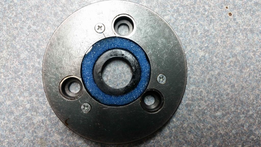

Yes they do. If you look on the inner part of the clutch they run down the inner side. When I got the first one they provided a replacement without even wanting to see it or for me to return it. When I got the replacement and it was the same I sent a picture of what I was talking about. They did not respond and I had ebay contact them and the the offered the refund. This leads to me to believe that it's a problem and they know about it. -

I don't see the point of a crack on purpose, a crack at a screw hole is not good. The second one I got was the same. I sent a picture to Caltric they offered me a refund with no explanation about the cracks. -

I got this starter clutch from Caltric and it looks cracked at those 3 screws. This is the second one and they were both the same. Do I need to be concerned about this or should I return it?
