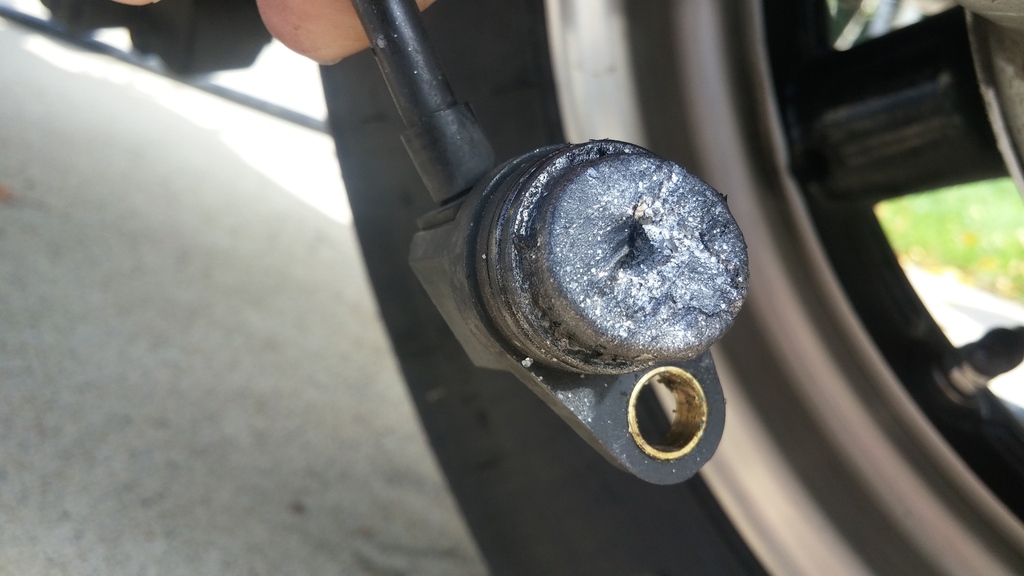

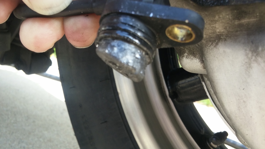

	A spare speedometer sensor for a second gen? Checked my speedo sensor last week and it appears to be shot. Not sure why it happened, but I hope someone here has a parts bike and has a sensor in good condition. Willing to pay a reasonable amount. Please and thank you!! !
	Took off for a ride yesterday and noticed my speedometer (2005 Midnight RSV) was not working, nor was the odometer. But the clock did. What else doesn't work? Well the auto turn signal cancel. But the turn signals work. And the cruise control. Lights flash on and the on indicator light stays lit. Checked the fuses on the left side and all is well there. Haven't removed the lower right cowling to check those yet. Manual shows all three of these controlled by different fuses anyway. So where do I look now?? Thanks as always for any info shared!

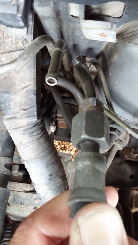

	.thumb.jpg.9a7aacfec0cd950561d39d2b00b32e01.jpg)  Need advice with auto gas line problem Please!frodotoo replied to frodotoo's topic in Watering Hole Got it apart using the Dremel and cutting discs. Tried everything I knew (PB Blaster & Liquid Wrench) vise grips/wrenches before using the dremel. Cut grooves in opposing sides of the stationary nut and then cut the end off. After that it spin meekly off with my fingers barely turning it. $92 for a replacement line, unless of course I wanted it Tuesday instead of Thursday which would have been an extra $21.
	.thumb.jpg.9a7aacfec0cd950561d39d2b00b32e01.jpg)  Need advice with auto gas line problem Please!frodotoo replied to frodotoo's topic in Watering Hole Here it is The repair manual had either a pushbutton type connector or a rounded plastic collar type connector that required a special tool.
	.thumb.jpg.9a7aacfec0cd950561d39d2b00b32e01.jpg)  Need advice with auto gas line problem Please!frodotoo replied to frodotoo's topic in Watering Hole Ditto Puc, heading out to the Maggie Valley area in early July with some other folks from the site here and then after that who knows what the rest of the riding season may bring?? I am ready to abandon the great white north this year, been looking for a retirement home in Georgia. I hear you can ride nearly all year long down there.
	.thumb.jpg.9a7aacfec0cd950561d39d2b00b32e01.jpg)  Need advice with auto gas line problem Please!frodotoo replied to frodotoo's topic in Watering Hole Dremel tool and grinding disks cut the top off the fixed nut and it relieved the pressure enough to just spin off in my hand. Seems every time you match steel and brass at a connection like that they never seem to want to come apart. Now I just need to find a replacement line. Off to Orlin's this weekend to learn a little about MC maintenance 101.
	In trying to sell off a 2002 Hyundai Sonata V6 I noted a small gas leak in the high pressure line to the fuel rail. The line is connected to the SS gas line to the tank with a compression fitting (?!) It won't come apart no matter how hard I try. There is no pressure on the line and I used flare nut wrenches (19mm and 14mm) that rounded one side of the the compression nut. And yes I'm turning it the right way! I've not rounded the other side yet and have not tried vice grips yet either. I don't think trying to heat the fittings of a gasoline line would be a good idea Any thoughts on how to free this connection?
