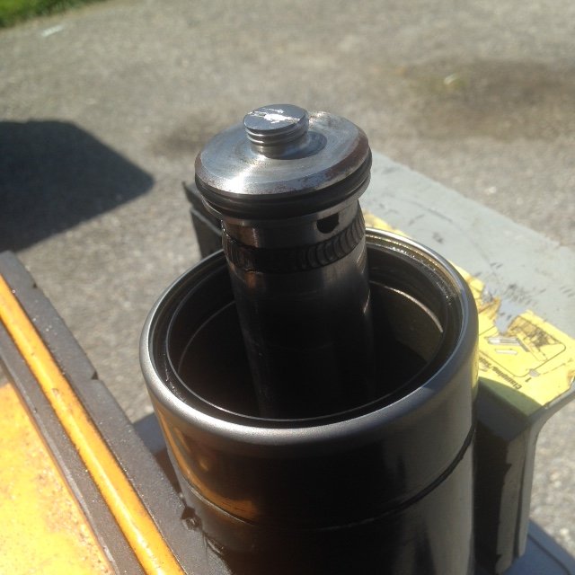

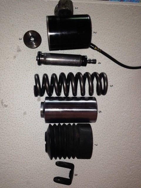

Puc, I just saw this post after I PM'ed you. Here are some pics of the dis-assembled RSV shock. It is very different from the 1st Gen. In the RSV the oil and air share the same chamber. Contact me with any questions you may have. Fitz -
