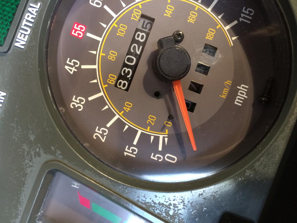

Okay..so I cleaned the cable and I think I found the problem which was a kinked cable housing. So I pulled and other on off of a parts bike and cleaned that one. Now the needle is "stuck" under the pin. Won't move in any direction. Next step ??? Do I have to pull the whole console out and take it apart ? I actually have a guy driving from Phoenix to look at it and was hoping to have this fixed .. No good deed goes unpunished.. I should have left it alone and sold it as is... UPDATE: Just took it for a spin and the odometer is working but the speedo is not ....;.
Thanks. I just got back from getting brake cleaner and cable lube...hope I do not have to take the whole speedo apart...
Hi guys, I am in the process of (sadly) selling my beloved 89. As a quick background I am buying a friends Stratoliner and had planned on keeping my 89 and actually have time to work on it and really try to get to all those "little" things .. Since I just "inherited" my son-in-laws 86 Venture, I can't keep all 3 bikes and my daughter can't part with his 86 right now. So I am going to fix his up and ride the Strat for now. Anyway, I was trying to do the right thing and get the bike ready for a new owner...and was starting to get that winter "speedo whine" again. I pulled out the lil greaser adapter that Golf & Venture had developed and greased the speedo as I have done before. Anyway, now my speedo is acting weird. At first it would not work, so I reinstalled the cable and checked it so that it was seated properly. Now after several tries, when I take it for a spin it flips very quickly all the way around and stays pegged on the wrong side of that little pin. If I disconnect it from the bottom and spin it with my fingers, it will return to the correct side of the pin, but after reassembly and test ride it spin back around. I have 3 people interested i seeing the bike and really need to get this corrected....HELP !! Any ideas ?
