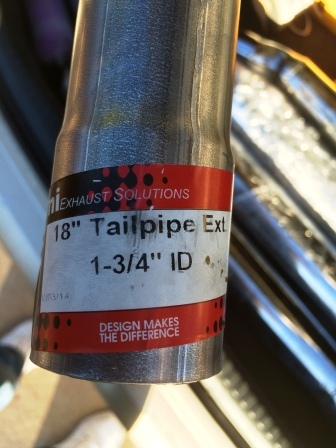

WOW..this has turned into a Royal Pain in the exhaust. Took the RK's and the original set that was on my 89 to a Midas shop. They couldn't do it. Said they did not have anything small enough to make th epipes and bends. Nothing under 2-inches. They recommended a custom shop down the road. There was a Harley sitting out front. Popped the trunk explained that I only needed a connecting pipe with a 16-degree bend in it to measure the same length as the originals from end to end. He hemmed and hawed and wanted the whole bike saying that he couldn't guarantee that he could make it perfect without the whole bike. . I again explained that I just needed the connecting pipes and I was making a mount so I "wiggle" room. He made a comment about putting Harley pipes on a 'Jap" bike and decided he did not want to mess with it. Drove further down the street to a VW repair shop thinking they must use smaller pipes. He didn't have a clue and did not want to get involved. Guess I will keep looking. I need to measure the inside diameter that goes into the RK and the outside diameter of the end that attaches to existing and just see what I can come up with. I know with the right amount of $$$$ anything is possible but I was hoping that it would be easier. -

Thanks Kevin, that is pretty much what I needed. I didn't want to have to take the bike to the muffler shop to get everything to fit. It looks like just getting two pipes bent and possibly flared is all I need. The brackets I can create. -

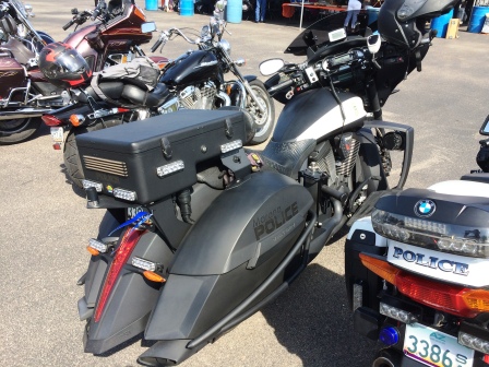

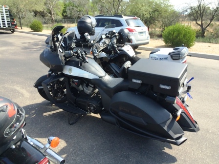

Last Saturday I rode Road Guard with Full Throttle Ministries who has supplied the road Guard for 6 years for the Kelli's Ride Cancer fundraiser for Juvenile Diabetes Foundation. Had a blast. One of the police escorts was the Marana Police Department's Victory "stealth" bike. The flat black, fully loaded Victory. Front and rear radar. Very few times you can ride fast and break a few traffic laws with a cop around like we did as Road Guard . My speedo needle was intimate with 95 several times going from back of the pack to the front to block an intersection. Only had one intersection we couldn't block since like the commercial says: "You can't stop a train"
