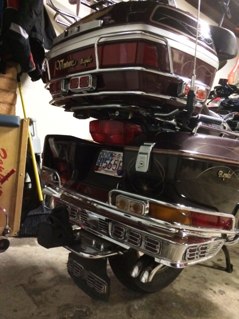

	Rabbit trail........ Back off track... So how much do you think it cost to switch everything over to LED's ? I have disconnected my anti-dives ( which a BIG difference) but I also have a lot of lights..in fact I just finished adding the OEM trunk guard on mine, although I wired the four rear lights to the brakes and the four side lights are brake/turn signals, there is a total of 26 additional lights on the rear not counting the stock rear light. I know I read something about converting to LED in the past, but doesn't it take adding something to make the LED's work in place of the stock ? Do they just plug in the same as the stock ? Inquiring minds want to know ??

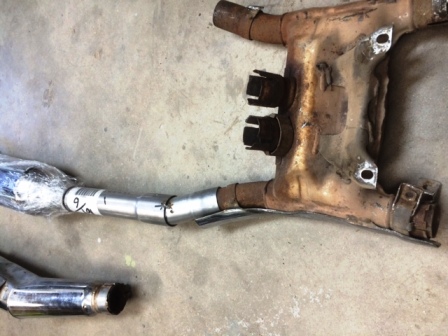

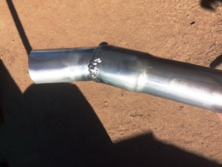

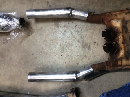

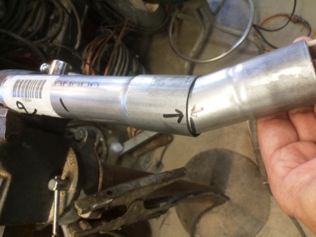

This is what I have ended up doing. After figuring out that I could not get the pipes "bent" easily ( never did find a shop willing to do them) I then re-evaluated the whole situation and came up with this configuration below. I went to a friend's shop to has just about every type of welder and we put this together. I am lucky that I have my extra exhaust collector to use while mocking up the pieces. So we got it all welded together and I only needed 3 of pieces from PepBoys. The bummer is that after loading all the other exhaust and stuff back into my car, I left the pieces at the shop. -

So I tried 3 more places today. 2 motorcycle shops and another exhaust shop. Yesterday was 2 places. I finally needed up at 2 different PepBoys and found some pieces so I could try to fabricate my own pipes. Tomorrow I will take them over to a friend’s shop to have the fittings welded together. Then I will still have to find somebody to bend the pipes. Nobody wants to work on anything under 2-inches. I took my extra crossover collector off one of my parts bikes and also have the pipes from my 87 off to try to mock up what I need. Here are the pieces I have so far: Exhaust HD Road King Conversion 2 – 1 ¾ ID X 1 ½ OD adapter Pepboys #17533 2- Connector 1 ½ ID Pepboys #17519 1 – 1 ¾ ID 18-inch tailpipe extension 1- Can Krylon High Heat black 1-Package Permatex Orange muffler sealer I am just documenting this so somebody else in the future might want to try this adVenture... -
