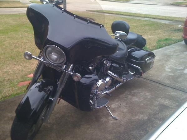

I bought a set of Burners high performance driving light kits QH-87CD which cost me only $18, and I mounted it on the edge of my Hoppe Quadzilla fairing on my 2006 Midnight RSTD. I wired it in to the CC port of the fuse box behind the lower front right cowling so that they come on with my headlight when I start the bike up. Check out my pix and here is the the link to the the lights on the Walmart website. http://www.walmart.com/ip/Driving-Light-Kit/16680058

I have a Hoppe Quadzilla Fairing on my RSTD 2006 and I love it, I have not noticed any change in the handling. Here are the specs, and if you do buy one get it from www.phatperformanceparts.com it is about $350 cheaper than buying it from Hoppe directly Hoppe Industries "Quadzilla" Fairing - Royal Star Tour Deluxe [Hoppe-12V:None] [Hoppe-Chrome:None] [Hoppe-iPod:Ipod CD5030] [Hoppe-MJ:Mini Jack Aux. Input] [Hoppe-Paint:None] [Hoppe-Radio:Eclipse CD5030] [Hoppe-Remote:Wireless Remote] [Hoppe-Sirius:None] [Hoppe-Trim:None] [Hoppe-WS:8" Light Tint] I have also attached some pix below
