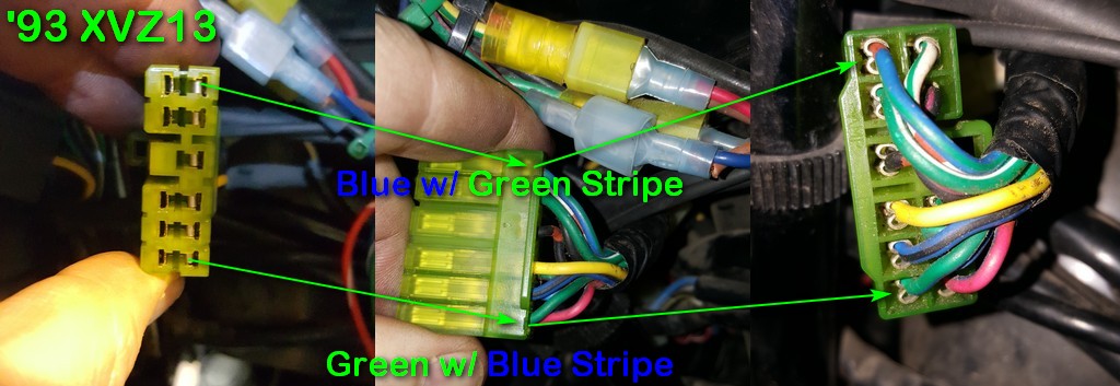

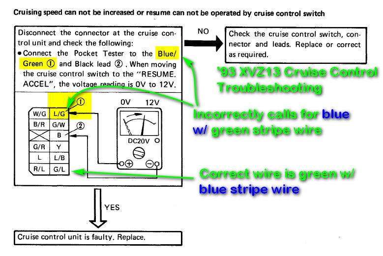

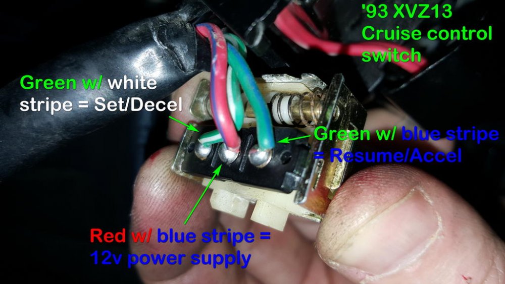

I found a mis-identified wire in the cruise control troubleshooting procedures on page 7-150. Holler if you think my connector is wired incorrectly or if you think I've made a mistake. The wire colors on my cruise control unit connector are: The wires on the cruise control Set/Resume switch are: The troubleshooting step for checking the function of the Resume/Accel position on the switch incorrectly says to check the blue with green stripe. The correct wire to check is the green with blue stripe. On my bike, the blue with green stripe has constant 12v power, which gave me the false indication that my cruise control switch was malfunctioning. Once I checked the green with blue stripe wire, the circuit properly changes from 0v to 12v when the Resume/Accel switch position is activated.
