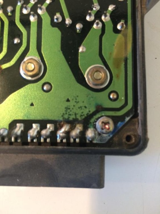

Problem area #3 on this long circuit the green conductive film is severely compromised over a long area on the left path. Is there a away to repair this? Can I bybass the compromised area by soldering a wire in there. Worth it? Worth trying? Is there a way know which circuit runs the front right coil on this CDI(#4?)

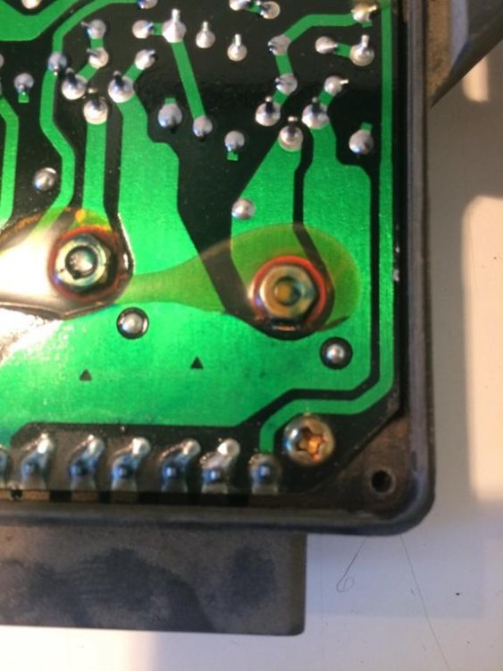

I have two Ventures. One of the ventures under most conditions will not spark the front right plug. According to my testings it seems to spark the front right coil only when starting the motor. Once the motor runs the front right plug never fires. I then swapped the CDI from my other venture and the bike runs perfect with the other CDI in place. I thus deducted that the problem is the CDI. I then removed both covers from both CDIs to compare them. Take a look:
