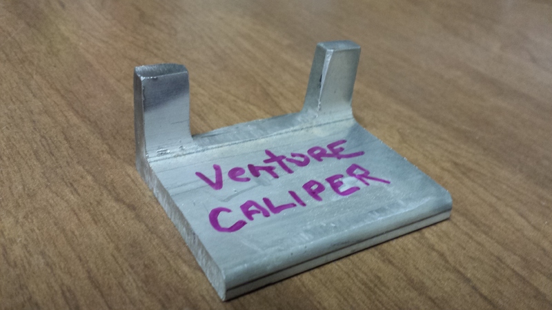

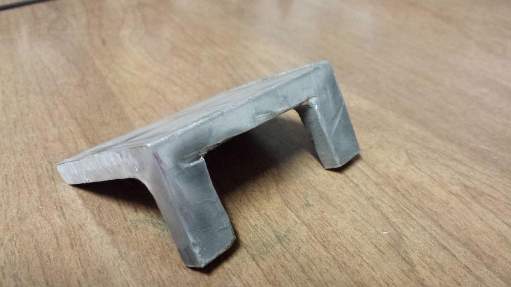

My little tool worked well. First front caliper I just cleaned one piston at a time (with them almost all the way out). The second front caliper one piston popped out so I cleaned both that way and left the seals alone (little scrubby pad clean). Bled both fronts but with new brake pads the front right (hand brake) was still a little soft. -

	My '84 xvz12D was sitting for a while before I bought it and all the calipers have one or two seized pistons. So trying to remove these opposing pistons and having a bear of a time. The manual says to use air to blow out one piston while clamping the other and then to rebuild that side and re-install and then hold the cleaned piston and blow out the other.. Rather than clamp the piston it said to use a "piece of wood" to block it. Well I went on youtube and found nothing on removing opposing pistons so I made a block out of 1/4" right angle aluminum. Going to try it tomorrow but at best I will only be able to do one piston at a time. Seems silly as I'd rather remove both pistons.. Is the trick just to get them both pretty far out by holding the stuck one and using smaller and smaller separating shims (I was using a cement trowel) and then at last moment hitting it with air? I suppose this would get one piston out and then I would need to use my piston inside grabber tool to twist and pry the second piston.... who has done this before?> I think Skydoc is doing it as a service.. oh crap. my jpg file attachments are failing to upload.. any recommendations here? files only 3-4000KB
