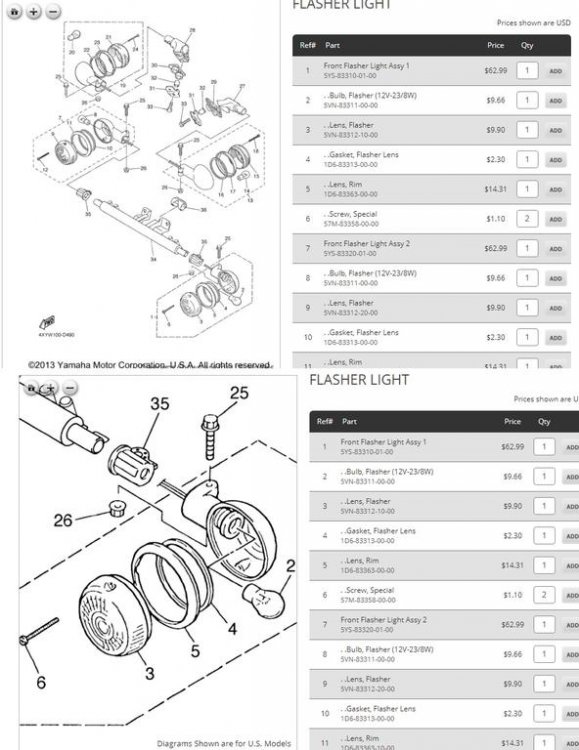

Looks like Yamaha has them in stock for less than $15.00 under a different part number for a 2012 RSV.

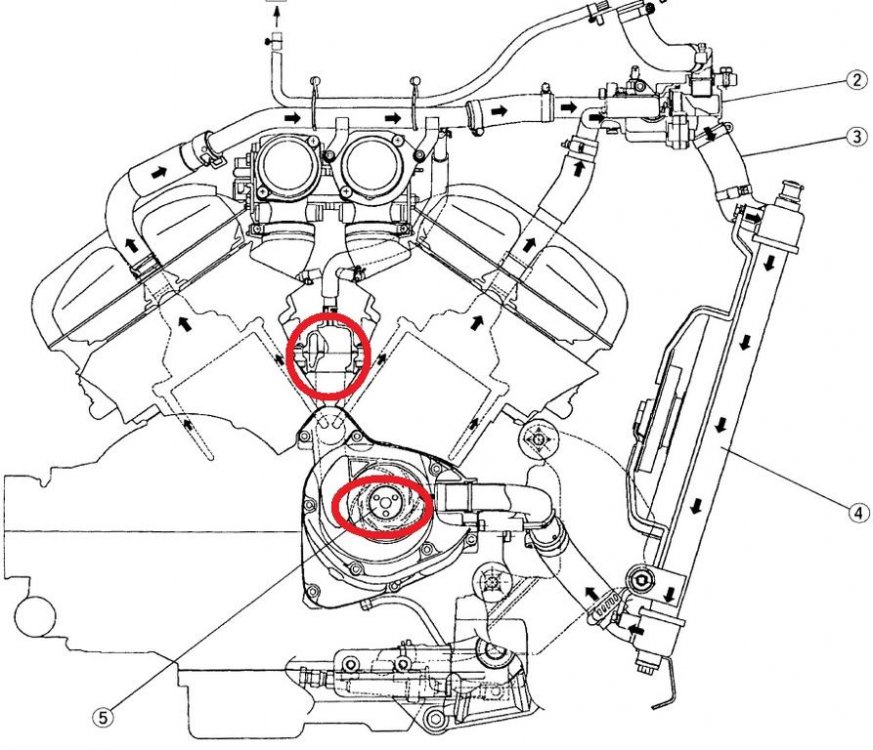

Just gettin broken in. What caused this condition to happen in the 1st place? I bet you mean it is mixing oil with the water. To "pass straight through the overflow" I don't know what that means. 1. I am wondering about your shop guys and "rough" head gaskets at 95K. Why? Was the coolant bubbling in the radiator with the cap off? A head gasket leak will "eat-burn-drink" coolant causing the coolant to go low, while producing exhaust gasses in the cooling system. A head gasket will have a witness fail mark on it where the coolant and the combustion process meet. Did they show you this gasket? 2. I agree with replacing all coolant lines, thermostats, radiator caps, water plugs, and flushing oil out of cooling system especially on a bike that has been in trouble and has 95K on it. 3. The three places water and oil could come into contact are: the head gasket, the "twinkie" crankcase breather, and the water pump seal. Any area that has been replaced already is not absolved from being guilty of mixing oil and water again. Bad assembly, using no sealer, reusing old gaskets instead of new, can be contributing factors to failure...again...and again.

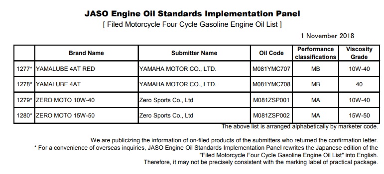

The JASO organization http://www.jalos.or.jp/ only published those that had: Paid the fees, and return the confirmation letters. (Starting about 4.6 in the JASO application process). This is at least the 4th month we have not seen ROTELLA on the list because that is how long I have been looking at it. Amsoil and Royal Purple I dunno.... (see below in the 1st pic where it says that, ".. they are publishing only those that have returned their confirmation letter.") Quicksilver and Yamalube are on the list. Quicksilver mentions in their advertising about companies that advertise JASO compliance but they are not really and I shot a copy of that in the thread where I was going to Quicksilver from Rotella. https://www.venturerider.org/forum/showthread.php?138309-Quicksilver-Oil-10W-40-amp-20W-50-JASO-rated (see the quicksilver advertisement that mentions companies not really being jaso rated even though they say they are)

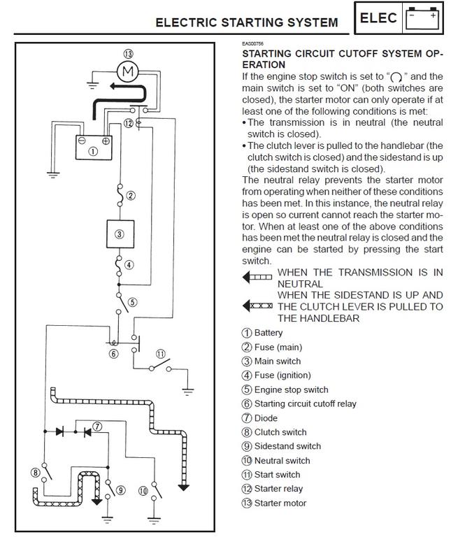

Turn Ignition key... NOTHING...
Du-Rron replied to KenM's topic in Royal Star Venture Tech Talk ('99 - '13)
Here is how to repair the ignition switch. Then buy the relay kit from djh3 to save the switch from future problems. I did. https://www.venturerider.org/forum/showthread.php?111175-Ignition-Switch-Repair see steps 11 and 12 before starting to determine if you can repair your current switch or if you have to order a new one. -
Help any? Check out the 3's and the 12's with a meter, then work backwards if those are not it. Bet 12 is corroded.
