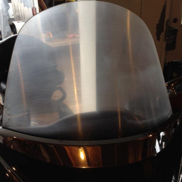

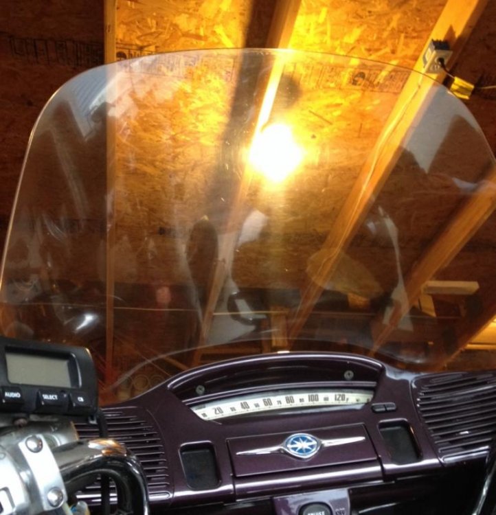

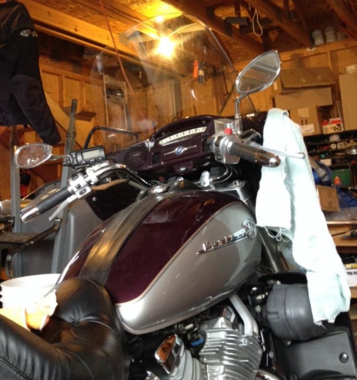

	My windshield is the original OEM on my '99 and although not yellowed or real cloudy; wasn't very clear when in headlights or evening sun due to glare from many fine scratches. It's a nuisance for me because this is a windshield that has to be looked through, it's too tall to look over the top. I remembered a post where it was stated that Plast-X did a good job for restoring motorcycle windshields so I bought Meguiar's Headlight Restoration Kit that had Plast-x plus some sanding pads, buffing wheel, and headlight protectant. It even listed that is it good for motorcycle windscreens on the package. I didn't take a before pic, but here's my bike from last week: The instructions said to sand windsheld with 1000 grit pad from kit. I only sanded the front side; it appears to get the most abuse. After sanding I wiped it with a clean microfiber cloth. At this point, I was just hoping I didn't ruin it! I then sanded again with 3000 grit, wiped, and applied plast-x, wiped, applied protectant, wiped again. Then I applied plast-x and protectant to the inside. Results: (first pic sanded with 3000 grit, second pic finished) More views: Not perfect, but looks much better while sitting in the garage.... As soon as it is road tested I will follow up with another post!
