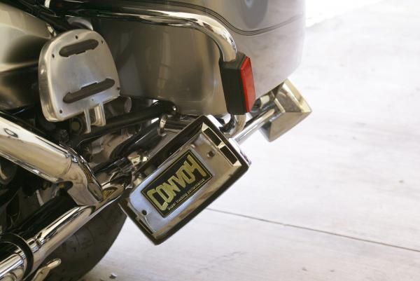

This link has led side markers that look like the orignal marker reflectors. One of my first changes in lighting. You would never know the difference until truning on the ignition switch. http://www.electricalconnection.com/

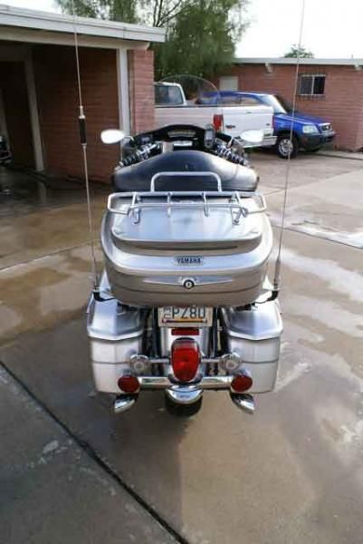

Most likely the switch contacts are dirty. A dealer would replace the switch. I on the other hand removed mine and shot some BowShield, even WD40, would do the job, into the switch. After wondering if anyone heard me when pushing the PTT switch I took a ma meter, a iN914 signal diode, and a 12 inch length of wire, placing the wire near the antenna. This is a crude, cheap, field strength meter. When ever pushing the PTT the ma meter show some current flow.
