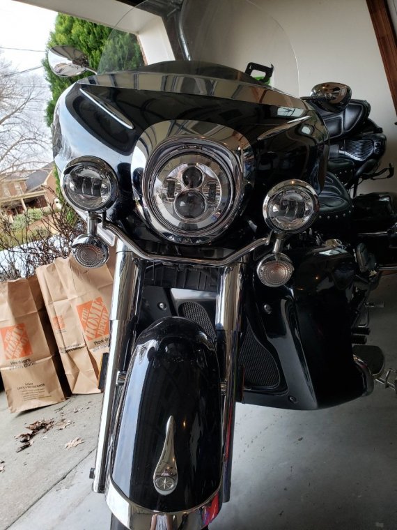

Swapped the terrible factory headlight and passing lamps for new LED units. I know I could've just swapped it out  the standard bulb for a LED replacement, but they rarely work well when retrofit into old incandescent housings.
	The mounting method i used required irreversible mods to the original light assembly and fairing to fit and retain adjustability. I bought a complete OEM headlight assembly off Ebay,  just in case something went wrong.

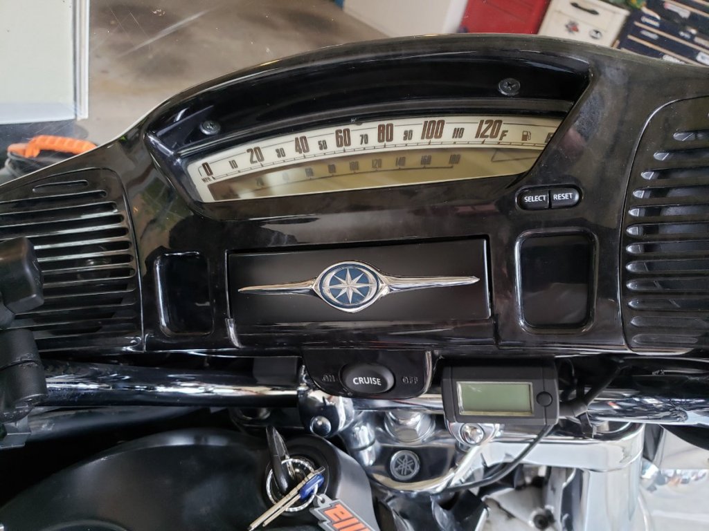

	While I was in there, I also replaced the original 12V power port with a high output dual USB unit, moved the aftermarket tach the PO installed from the handlebars to the underside of the dash, and my favorite part...
	I replaced the inoperable factory cassette player missing the door, with a functional unit with a door. Silly, I know...but it reeeeeaalllyy bothered me to stare at that broken unit and missing door. It's right below the speedo, so there's no ignoring it.

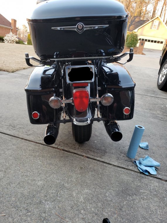

	Removed the luggage rack from the trunk, removed the saddlebag guards, and addressed the indestructible adhesive left behind by a matching pair of reflective "Jesus fish" someone stuck to each bag. Not sure what they used to attach them, but it appears to be either super glue or epoxy. Hard as a brick, and impervious to acetone, Goo-gone, alcohol, heat, plastic scrapers, etc. Only options were cover-up or sand and refinish the bags.
	I opted for a pair of imitation Lucas RER25 reflectors.
