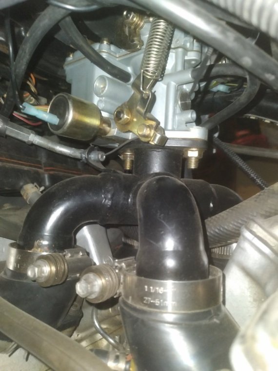

Baldphil Posted June 10, 2023 Share #1 Posted June 10, 2023 (edited) I read a few posts on here about switching out the 4 carb system with a single carb. I did this on my '83. Absolutely amazing! Now has electric choke and fuel shut-off. Just took a 700 mile road trip. Averaged 45.9 mpg! Edited June 10, 2023 by Baldphil hit wrong key 1 Link to comment Share on other sites More sharing options...

Baldphil Posted June 21, 2023 Author Share #3 Posted June 21, 2023 https://picclick.com/Yamaha-Venture-Xvz1200-1300-Single-Vw-Carburetor-Conversion-254019228752.html Here is a link to get you started. Mine was a little cheaper only because it didn't include the air filter. Shop around and u may find a better deal. You will need to buy different clamps that are more heavy duty. I got my clamps at a NAPA store. Here are a couple pics. I have to say it was the best investment I've made on my bike. Love the electric choke and fuel shut-off! Any questions, feel free to ask. Link to comment Share on other sites More sharing options...
Baldphil Posted June 21, 2023 Author Share #4 Posted June 21, 2023 Just now, Baldphil said: https://picclick.com/Yamaha-Venture-Xvz1200-1300-Single-Vw-Carburetor-Conversion-254019228752.html Here is a link to get you started. Mine was a little cheaper only because it didn't include the air filter. Shop around and u may find a better deal. You will need to buy different clamps that are more heavy duty. I got my clamps at a NAPA store. Here are a couple pics. I have to say it was the best investment I've made on my bike. Love the electric choke and fuel shut-off! Any questions, feel free to ask. And yeah, so much easier than trying to rebuild old wornout carbs! Link to comment Share on other sites More sharing options...

saddlebum Posted August 17, 2023 Share #10 Posted August 17, 2023 (edited) Personally I prefer the OEM carb setup. For one thing with four carbs you can balance the engine better which is specially nice if your compression between cylinders vary. With a single carb you cannot, you can only attain a general adjustment across the board. If a carb fails you can still run on the other three to get somewhere other than the side of the road. Finally looking at the setup you would also reduce air volume though I guess air velocity would increase, maybe. There is a reason why in the muscle car hay day we replaced 2 barrel carbs with four barrel or even 6 packs. JMHO. Edited August 25, 2023 by saddlebum 3 Link to comment Share on other sites More sharing options...
Pasta Burner Posted August 25, 2023 Share #11 Posted August 25, 2023 On 8/17/2023 at 7:24 AM, saddlebum said: Personally I prefer the OEM carb setup. For one thing with four carbs you can balance the engine better which is specially nice if your compression between cylinders vary. With a single carb you cannot, you can only attain a general adjustment across the board. If a carb fails you can still run on the other three to get somewhere other than the side of the road. Finally looking at the setup you would also reduce air volume though I guess air velocity would increase, maybe. There is a reason why in they muscle car hay day we replace 2 barrel carbs with four barrel or even 6 packs. JMHO. We need a “love” icon. My thoughts exactly! First thing that came to mind for me is “single point of failure” yeah we take risks only having two wheels but why add. Link to comment Share on other sites More sharing options...
