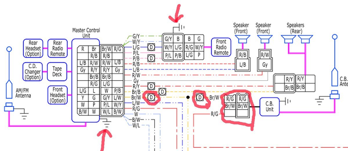

circa1968 Posted January 6, 2022 Share #14 Posted January 6, 2022 https://www.venturerider.org/wiring/99-09 Yamaha Royal Star Venture Wiring Diagram Rev B.pdf I’m sitting in Vegas airport on a 3-hr layover & was able to pull up the schematic on my phone, and miraculously could actually read it! You are looking for a brown/white wire. It goes from the fuse to both the head unit in the fairing & the CB unit located under the trunk. There are two connectors shown on the schematic. I’m 99.9% certain the connector going to the CB is under the seat. Start there! Not sure about the 2nd connector location though. I know there is a big connector under the tank & another one in the fairing, so 50/50. Link to comment Share on other sites More sharing options...

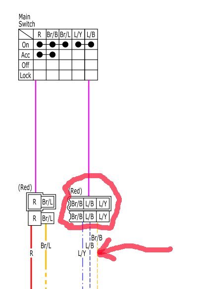

circa1968 Posted February 5, 2022 Share #23 Posted February 5, 2022 @Junior I took another look at the schematic and there are a couple more points to check out. See the two pics below. There are two more connection points on the Brown/white wire coming from the fuse. I'm 99% certain one of those is the one under the seat going to the CB, but not sure where the other one is located. Also, you will need to check your ground connections for the head unit and the remote. A broken/bad ground connection has the same effect as a broken/bad power connection - no current flow. And lastly, check the connection coming right off the ignition switch. It is the red, 3-pin connector under the tank. radio2.psd Link to comment Share on other sites More sharing options...
