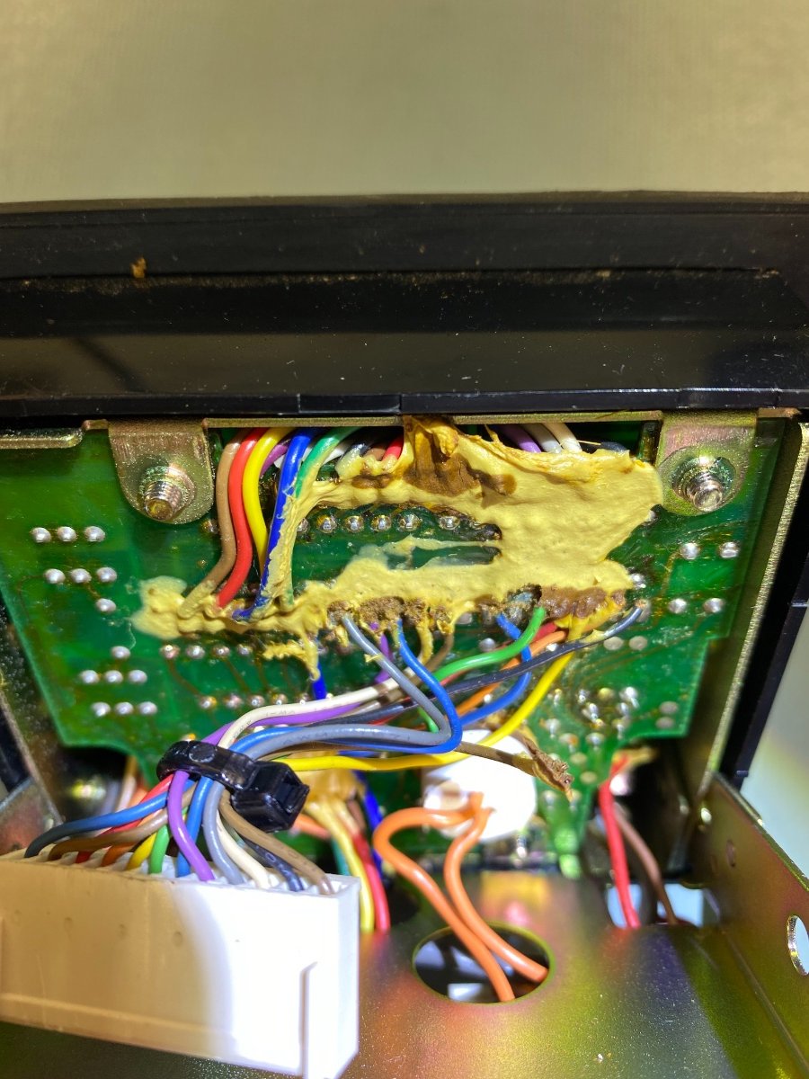

Pasta Burner Posted May 14, 2021 Author Posted May 14, 2021 Not much of an update, large chunk of my day got sidetracked waiting for a missile delivery that of course was hours late and ended with minor complication, but successful delivery. Just another day with the USAF 😜. I found the broken wire home and discovered a handful more that are hanging on by a strand or two. The conformal coating on those shows obvious signs of heat. I think I’m going to rework all those connections. Day off tomorrow but going in for some needed catchup so hopefully I’ll find some bench time to work it more.

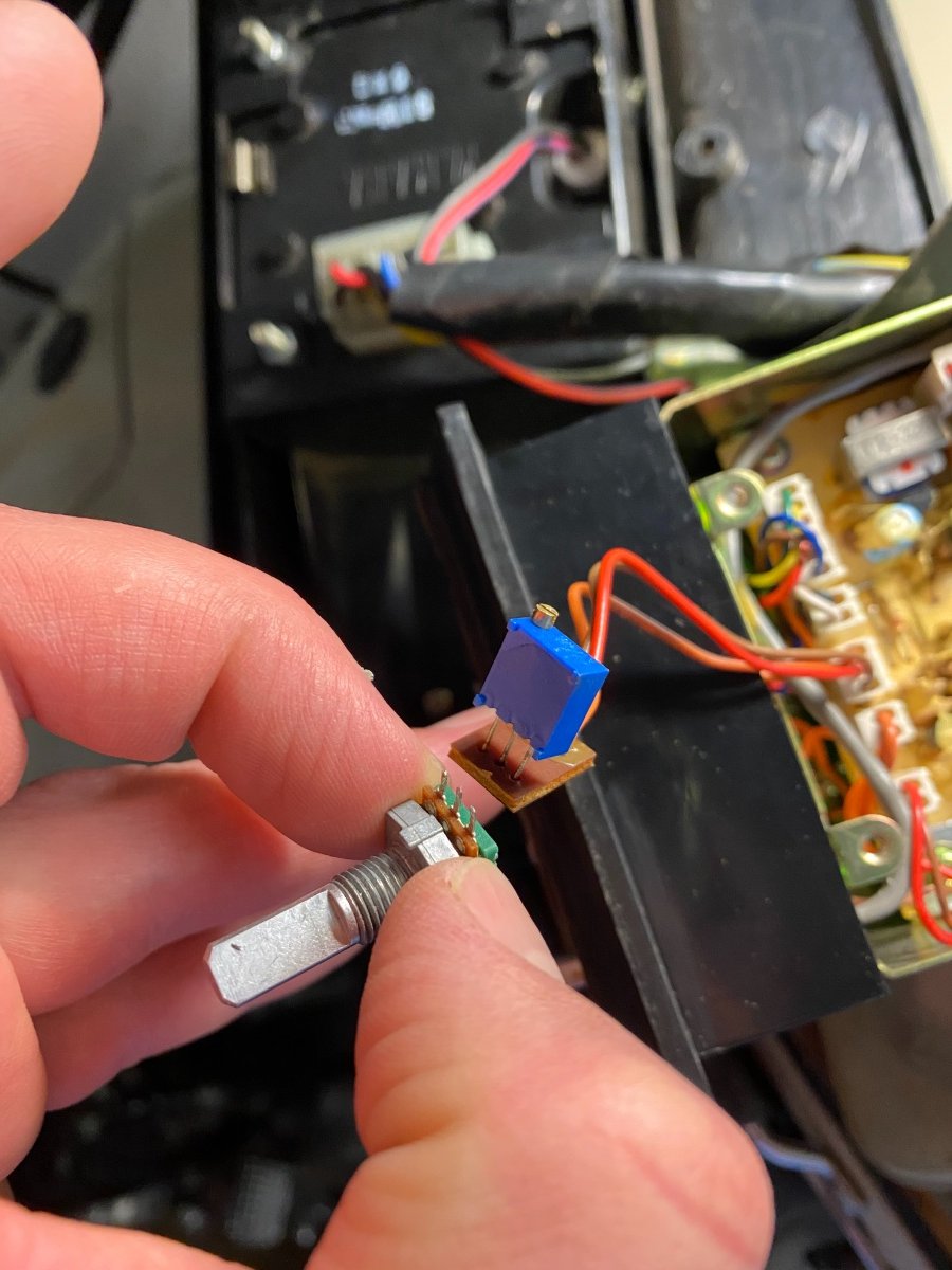

Pasta Burner Posted May 15, 2021 Author Posted May 15, 2021 (edited) So I still have no idea why it was displaying a “7” but that seems to be gone. Up until today I have been overly impressed with the engineering and quality of this machine. Maybe the CB units were outsourced but I came across the most inappropriate design for attaching fly wires to a circuit card. Most of the wires have broken strands. They thought it a good idea to solder 26 AWG stranded copper to a surface pad. Not even plated strands. Anyway I put the OEM design back in place and bench tested the squelch Pot which failed. Radio Shack didn’t have a 50k of the right dimension in stock but for a couple bucks I bought one electrically correct to perform another bench test. Everything seems to work correct now. I tested with my truck cb and it receives well and will transmit static to my truck when PTT is exercised. I tried using a 5pin cobra mic that I had laying around but it didn’t transmit, I’m guessing some incompatibility with multiple buttons. Now to find a Pot of the right size and electrical spec. Edited May 15, 2021 by Pasta Burner

Pasta Burner Posted May 15, 2021 Author Posted May 15, 2021 (edited) Here’s a little more clarification of my testing. Technically not “bench” test as I needed the bike connections. But I used comparable components. Now I’m getting the random “7” again which I fear will drain my battery so in the Interim I’ll leave it disconnected. Some pics of the test Pot and Erratic 7. Note: the unit is upside down. IMG_0116.MOV IMG_0115.MOV Edited May 15, 2021 by Pasta Burner
