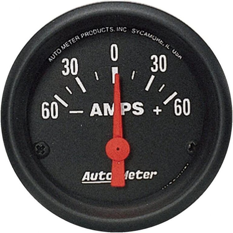

saddlebum Posted August 17, 2020 #35 Posted August 17, 2020 (edited) Dav? said: Thanks Bum...that's a great explanation. where do I monitor the amps in this situation? I'm thinking it'd be pretty difficult on each of the white wires that attach to the R/R... All the amp meters I'm familiar with are kinda bulky... Dave (Dav?)Not sure why you would want to bother, since as long as your voltmeter stays above 12.5 with everything on the bike turned on your charging system and battery are keeping up. If not then you either have a weak charging system and/or battery or your just running too many accessories, but since you do. There are various types of ammeters, the simplest set up is a direct ammeter. It will indicate "0" in the middle of the scale and the numbers increase in either direction. one direction indicating amount of acc. draw or discharge the other direction indicating amount of battery draw or charging. They come in various load sizes for example 50-0-50 or 100-0-100. Disconnect all wires from your positive post. now connect only the heavy wire from your starter solenoid and a wire from one post of the ammeter to the positive post (10 ga recommended). Now all the remaining wires will connect to the other post of the ammeter. The needle will read to one side or the the other side of zero depending on currant flow. If the battery is charging the needle will go in one direction indicating the amps drawn by the battery while recharging. The lower the state of the battery the more it will draw and the higher the reading. as it reaches full charge the ammeter will move closer to zero. How high the ammeter reads is also affected by the number of acc. you turn on but as long as the needle stays to the one side of the zero your battery is charging and keeping up with the load demand. If the needle goes to the other side of the zero your acc. are drawing more than your battery can manage and you are now reading the amount the battery is discharging. If you turn acc. on with the bike not running you will a larger discharge than if the bike is running. Fire the bike up and the indicated amount of amps discharging will go down the needle moving closer to zero. ideally you want the needle to move to the opposite side of zero once the bike is running indicating the battery and charging system is keeping up with demand. If not you either have too many acc. drawing power or the battery and charging system is weak and cannot keep up with the demand. In this setup starter draw does not come into play since it will draw more than the ammeter is designed for and this is why the solenoid heavy wire is connected directly to the battery. You could get a higher reading ammeter but then you would give up a level of sensitivity. Ideally you want an ammeter with a scale high enough to handle most of the currant used by the bike including max battery draw while charging but not including the starter draw and low enough to be as sensitive as possible to minor fluctuations. Now from the above basic set up you can get more sophisticated ones that use induction pickups and even very accurate digital ones that will read put both volts and amps. Picture is of basic gauge the amazon link is an example of a digital one. https://www.amazon.ca/Battery-Monitor-Voltmeter-Ammeter-Transformer/dp/B07D35MFBQ/ref=asc_df_B07D35MFBQ/?tag=googleshopc0c-20&linkCode=df0&hvadid=292965357502&hvpos=&hvnetw=g&hvrand=2946946082963120748&hvpone=&hvptwo=&hvqmt=&hvdev=c&hvdvcmdl=&hvlocint=&hvlocphy=9000858&hvtargid=pla-552976227978&psc=1 Edited August 17, 2020 by saddlebum
