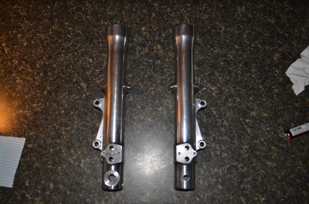

uhfradarwill Posted April 25, 2019 Posted April 25, 2019 (edited) I have the bike on an air lift table doing the fork seals. I figured I may as well clean up the lower units. I went with All Balls seals per suggestions on this site. I have the bike strapped down with a center jack on the table. The rear tire can drop straight down. Anyone have any luck maybe removing or pivoting the rear caliper assembly out of the way to remove the back tire without removing all the saddle bag and grab bars? Thanks Will Edited April 25, 2019 by uhfradarwill
Marcarl Posted April 25, 2019 Posted April 25, 2019 Them tubes look good, really nice. Now buff them on a buffing wheel and then finish them with Classic Cloth. Clean them once a year with the cloth and you'll be a happy camper. On the rear, the caliper may not be your biggest problem, somehow you have to get the axle out as well.

cimmer Posted April 25, 2019 Posted April 25, 2019 getting the axle out is the biggest issue with dropping the rear wheel assemble. You need to remove the bags for that but you might be able to leave the racks for them in place. With the axle out the rear rotor might be able to clear once it is removed from the rotor. Another thought is to install Progressive fork springs and get some plates to remove the anti-dive solenoids on the lower forks. http://www.fastfromthepast.com/fork-anti-dive-bypass/yamaha-anti-dive-bypass I have my anti-dives disconnect on my 89 VR as I have the Progressive fork springs and I plan on getting some block off plates and installing them next time I swap out my fork oil. By the way your lowers look great. Good job. Rick F.
