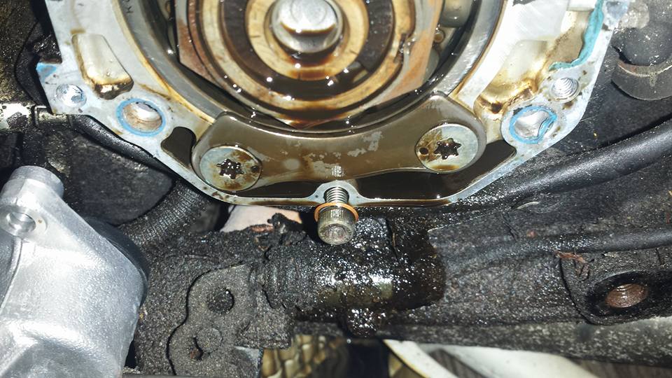

Prairiehammer Posted July 4, 2018 Posted July 4, 2018 I know my 83 may end up with issue but, I noticed last night when I replaced the clutch seal that my gear box has 4 bolts and all 4 had punch marks on the bolts. So here is my question why would they be like that as its not to help hold the bolts in place as it is on the heads. So could this possibly mean my washer has been repaired? I am not sure what four bolts you are talking about, but I suspect you are talking about the four flat head screws with the Torx socket head under the middle gear cover that retain the middle gear retainer plate? If those bolts/screws are what you are wondering about, the "punch" marks on them are in fact staking the bolt/screw heads. The punch marks are made at the factory and do not indicate a repaired thrust washer. There was no dealer applied mark to indicate a repaired second gear. Replacing a worn thrust washer was not a warranty item. Furthermore, a repaired second gear procedure includes replacing the thrust washer and new spec second gear/dog. The "punch mark" that is so often talked about was to indicate that the stator cooling kit had been retrofitted. The single punch mark in that case was supposed to be applied by the dealer onto a smooth blank boss on the crankcase near the middle gear cover. M84-025 Stator Cooling Kit Installation.pdf
snyper316 Posted July 4, 2018 Author Posted July 4, 2018 I am not sure what four bolts you are talking about, but I suspect you are talking about the four flat head screws with the Torx socket head under the middle gear cover that retain the middle gear retainer plate? http://www.venturerider.org/forum/attachment.php?attachmentid=113477http://www.venturerider.org/forum/attachment.php?attachmentid=113478 If those bolts/screws are what you are wondering about, the "punch" marks on them are in fact staking the bolt/screw heads. The punch marks are made at the factory and do not indicate a repaired thrust washer. There was no dealer applied mark to indicate a repaired second gear. Replacing a worn thrust washer was not a warranty item. Furthermore, a repaired second gear procedure includes replacing the thrust washer and new spec second gear/dog. The "punch mark" that is so often talked about was to indicate that the stator cooling kit had been retrofitted. The single punch mark in that case was supposed to be applied by the dealer onto a smooth blank boss on the crankcase near the middle gear cover. http://www.venturerider.org/forum/attachment.php?attachmentid=113479http://www.venturerider.org/forum/attachment.php?attachmentid=113480 :bang head: well it would be nice to know if it has been, instead of one day not having it.

Prairiehammer Posted July 4, 2018 Posted July 4, 2018 Prairiehammer did you go tear a bike apart to post them photos. YEP. Just for you. And it is only 100° here, 121° in the shop. No sacrifice too large for a fellow VentureRider.

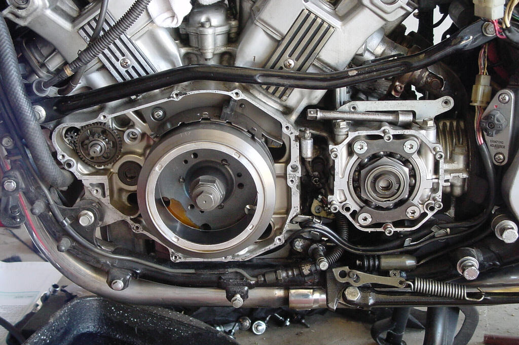

Marcarl Posted July 5, 2018 Posted July 5, 2018 On the second gear issue if you look at the picture, the second one is probably the best, you'll see a large nut with the 4 bolts around the outside that you said had punch marks. In the middle of the nut there is a shaft with a shaft inside of it, well at least that what it looks like. On the center shaft then you'll be able to locate 2 half moon washers that are sitting in a groove on the shaft. Yep! those are the culprits. The half moons are there to hold a spring onto the shaft and that spring is not a wuss. So the whole kit and kabudal has to come apart to get at those 2 half moon washers,,, but in your case all is not necessarily lost. Look closely at the one you have on your bike and see if the half moons have been worn by the shaft, if yes, then you will have some work to remedy that issue, if there is no wear, then I would suggest that they have already been renewed. The original washers were made from too soft metal and so wore down, which allowed the shaft to slightly move inwards, which allowed the second gear dogs to slide out of position. The replacement washers are of harder steel and so can stand up to the job at hand.
