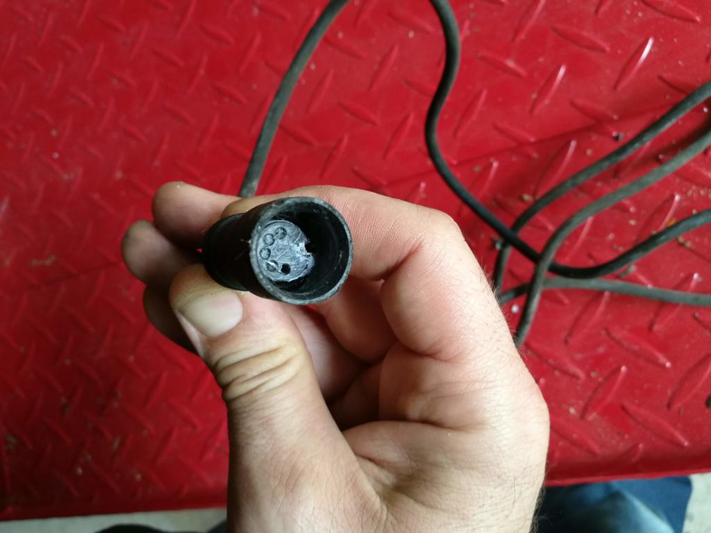

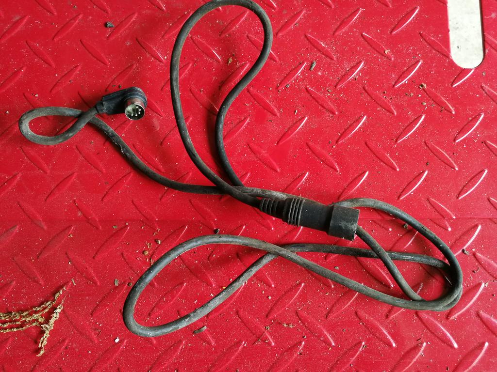

frankd Posted May 25, 2018 Share #1 Posted May 25, 2018 The front audio cable in my 89 has developed an open wire. It started out just intermittant, but now it's open about 95% of the time. This is the cable between the radio chassis and where you plug in your rider's helmet. Seeing as the bad spot was near the connector (the one on the tank cover), I decided to open it up and repair it. The connector wouldn't pull apart, so I had to carefully cut the rubber boot, and when I got it open I could see where they had epoxied the connector and boot together to support the wires. If I have to fix my old cable, I'll buy a 5 pin din female inline connector. Before I do that, is there anybody out there that has an extra cable from a parts bike? I'd be glad to buy it. Frank Link to comment Share on other sites More sharing options...

djh3 Posted June 5, 2018 Share #4 Posted June 5, 2018 I dont have that particular cable, but I do have connectors you can repair yours with. Link to comment Share on other sites More sharing options...
utadventure Posted June 6, 2018 Share #5 Posted June 6, 2018 FYI. The cable is the same as the old AT Computer Keyboard extension cord. You may have to move the plugs to different positions in the amp inside the left faring because of the 90* of the original cord. Link to comment Share on other sites More sharing options...
