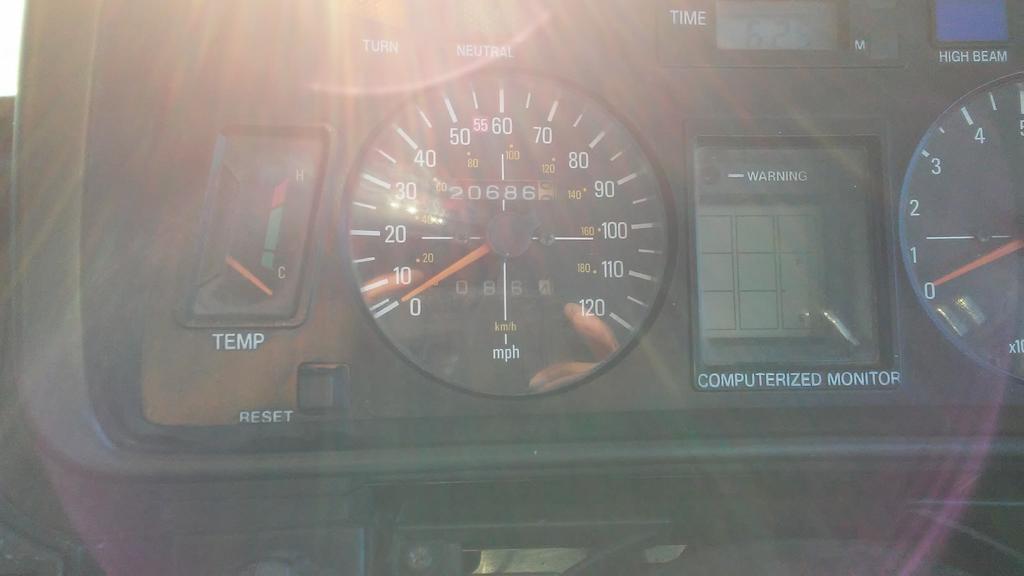

I forgot how yellow the dash looked when i first got Tinker, not its got the LED White/Blueish color..

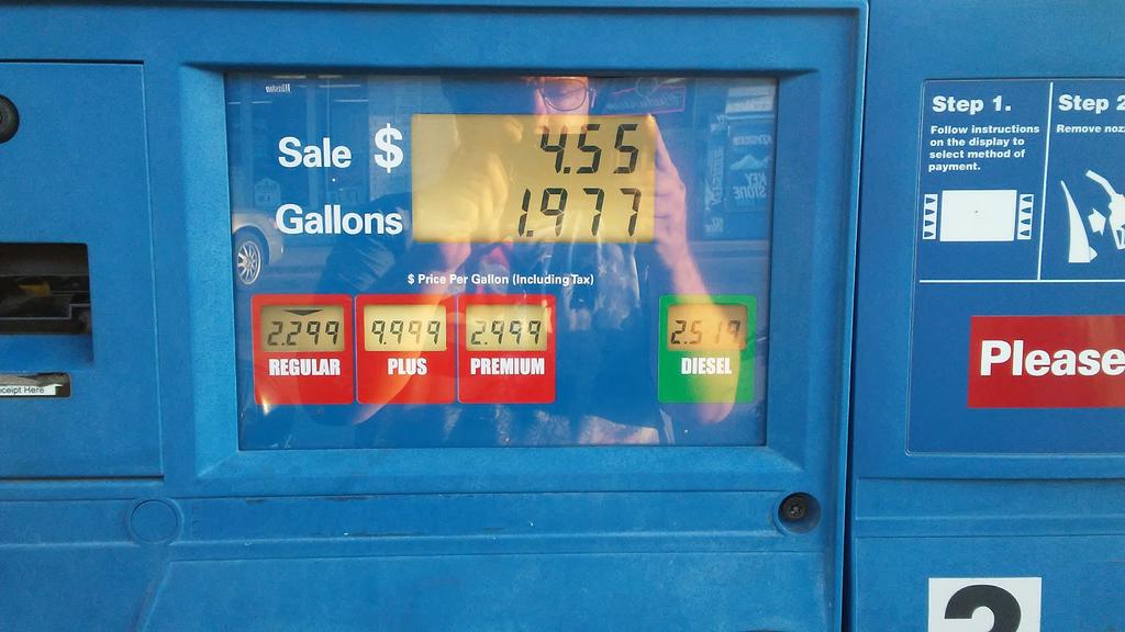

Just to give you all the Idea here is my latest trip I filled up in Fayetteville Arkansas and road home and refilled the tank I just put in the new plugs and pictures will tell the story hear I have the 1983 Yamaha Venture.... I checked Sync and tweeked with the Colortune... 86.4 Miles and filled back up as much as I could cram in the tank only took the 1.977 gallons!!!

Wow! That 89 octane is quite expensive!
I never even noticed that till now.. Stations that sell non ethanol premium used to sell midgrade were forced to stop because it didn't meet standards of 10% ethanol... Because midgrade was just a mix of 87 and 91... I used to buy the midgrade to get less ethanol..... And was only 5-10cents more so figured why not.... Darn epa or whoever comes in to tell gas stations what they can or can't do!!
