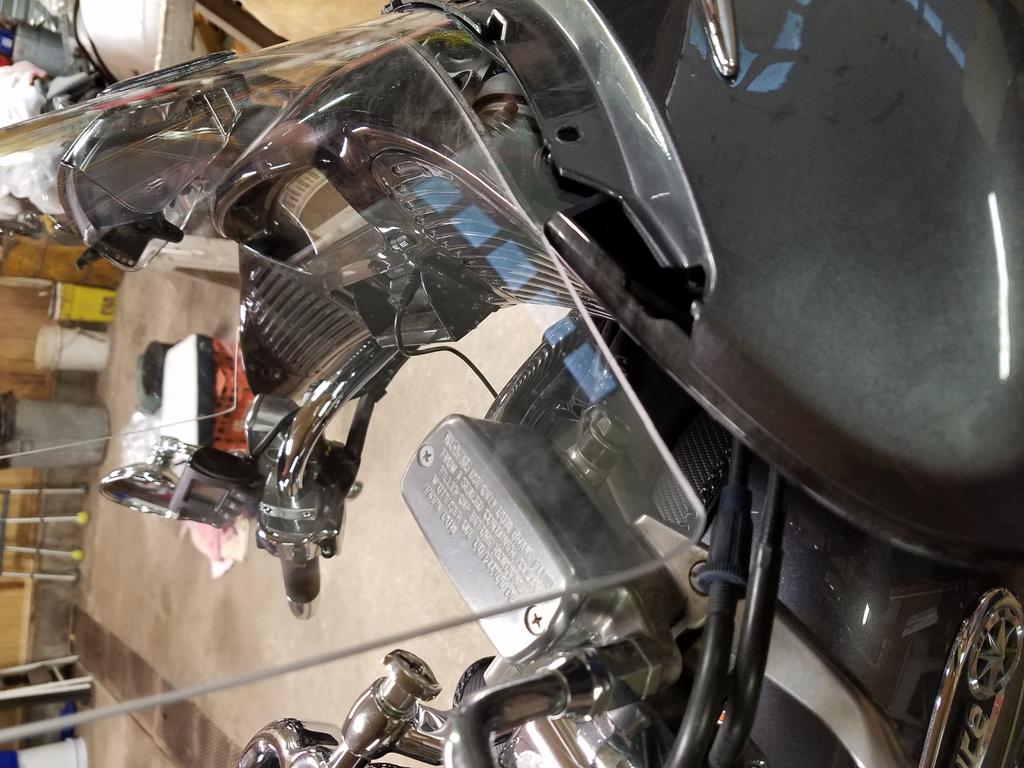

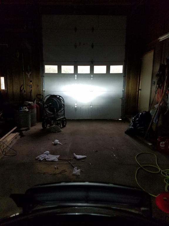

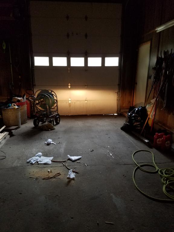

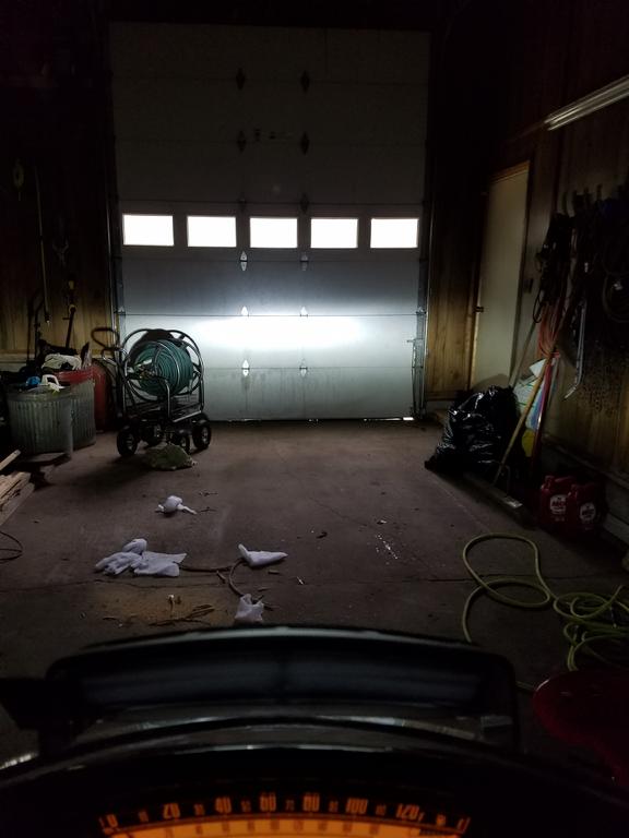

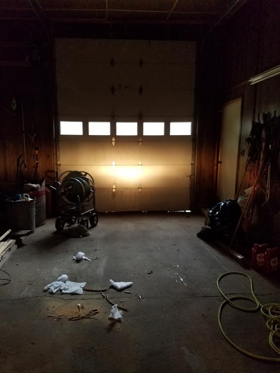

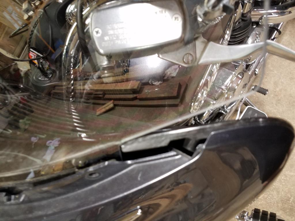

Statussymbol Posted August 22, 2017 Author #4 Posted August 22, 2017 Well, got the light installed today during the eclipse...... the last pics were of the new F4 Custom tall and wide shield I ordered, but the ends do not follow the lines of the fairing....anyone who has a wide F4 shield have the same issue? Thanks stat
camos Posted August 22, 2017 #5 Posted August 22, 2017 Statussymbol said: Well, got the light installed today during the eclipse......Does the Gen 2 have an adjustment knob for the headlight like the Gen 1 does? Looks like you aimed it higher than the original.
Statussymbol Posted August 22, 2017 Author #6 Posted August 22, 2017 camos said: Does the Gen 2 have an adjustment knob for the headlight like the Gen 1 does? Looks like you aimed it higher than the original. yes it does, waiting til tonight when I ride to work to adjust, LED shines a little farther down the road than stock.
WIZ Posted August 22, 2017 #7 Posted August 22, 2017 The f4 shield does not follow the contour of the fairing. Ron
Flyinfool Posted August 22, 2017 #8 Posted August 22, 2017 Statussymbol said: yes it does, waiting til tonight when I ride to work to adjust, LED shines a little farther down the road than stock. The LED will shine farther down the road because its low beam is aimed higher then the OEM high beam. So you are effectively riding around all the time, day and night, with your hi beam on. You can use your pics to set the top cutoff of the lo beam to the same height on the garage door as the OEM light was, ALL of the other drivers on the road will be happy if you do.
BratmanXj Posted August 22, 2017 #9 Posted August 22, 2017 Flyinfool said: The LED will shine farther down the road because its low beam is aimed higher then the OEM high beam. So you are effectively riding around all the time, day and night, with your hi beam on. You can use your pics to set the top cutoff of the lo beam to the same height on the garage door as the OEM light was, ALL of the other drivers on the road will be happy if you do. I don't have the manual in front of me, but is there a formula (X height at Y distance) that you aim for with these bikes. I know cars you usually do 25' distance.
camos Posted August 22, 2017 #10 Posted August 22, 2017 BratmanXj said: I don't have the manual in front of me, but is there a formula (X height at Y distance) that you aim for with these bikes. I know cars you usually do 25' distance.There is a formula and hopefully I am remembering it correctly. While sitting on the bike about 25' from a flat wall, get a measurement from the ground up to the centre of the the headlight. Transfer that measurement to the wall then make a mark 2" down. While still sitting on the bike, aim the top edge of the headlight beam to the lower mark. I think this is pretty much the same method used to adjust a car's headlights.
