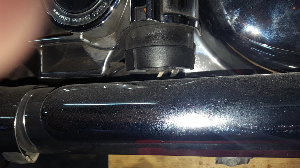

cwhite123174 Posted July 25, 2016 Author Posted July 25, 2016 I bought the Wolo and got the harness and bracket from Larry but apparently they have changed the design of the Wolo because it is not install friendly! My better half thinks I am too picky but I don't like how it mounts. It mounts crooked! I broke one of the wires from Larry's harness but that's easily fixable. Just got to go get the other pc. Any does what I can do here? I am concerned that those wires are so close to the exhaust. I could probably deal with the way it sits.... Crooked. Don't mind the bare wire in the picture. I was just trying different ideas with everything. That's the pc I broke. http://uploads.tapatalk-cdn.com/20160725/8eb3aad8836ce41694b09bbc1f6a5e09.jpghttp://uploads.tapatalk-cdn.com/20160725/7f2ad699dd0fab2b5f941e31286731a8.jpg
djh3 Posted July 26, 2016 Posted July 26, 2016 Ask Larry. But what I would do is bend the connector that goes on the horn at a 90 deg, then zip tie the wires up so they stay off the exhaust. I built my own bracket and harness, but thats what I had to do as space is limited there. Had to do the same with the one I mounted up in left front foot fairing.

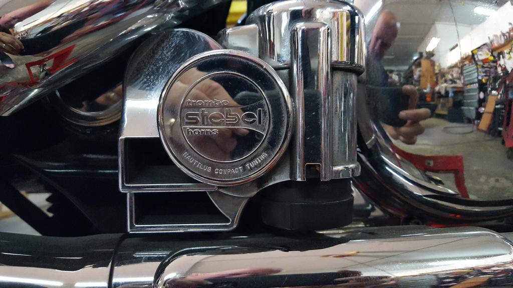

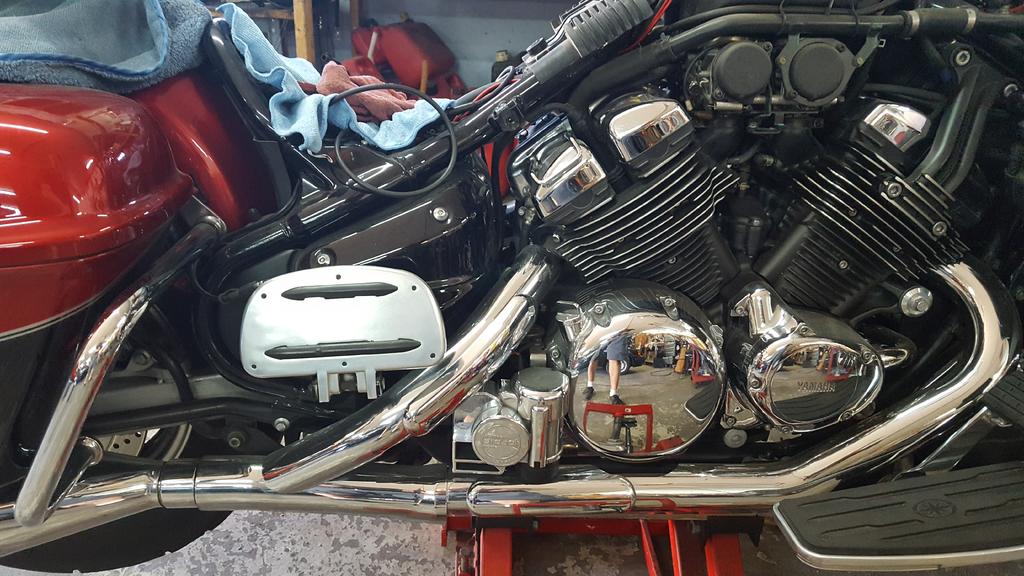

DarrinGT Posted July 26, 2016 Posted July 26, 2016 It looks like it is sitting too high, making it hit the rear exhaust pipe and sit crooked, is there a spacer under the bracket where it bolt to the motor? Maybe remove it,. or try to make it sit lower,.. Mine sits way closer to the exhaust pipe and I did what DJH3 suggested, Bent the connector 90 deg and zip tied them up, No problems. Couple pics,.. By the way, This horn works Awesome, I still have the stock horn in the front fairing that I can give a quick "toot" before the Stebel horn spools up, but when it does, I am heard!
cwhite123174 Posted July 26, 2016 Author Posted July 26, 2016 I am not worried about the wires anymore. I have that fixed. I am however concerned with how the Wolo mounts with my bracket. It basically just sits over the bolt. I am going to maybe straighten the bracket out so I can mount through holes rather than just slipping it over a bolt. Gonna try to figure out how to get it sitting straighter too. That crooked look drives me crazy! It will just take some modification of the bracket I'm sure. This Wolo Bad Boy Horn is bigger than it looks but it will sure get some attention! It's loud! Very loud! Exactly what I was looking for!
