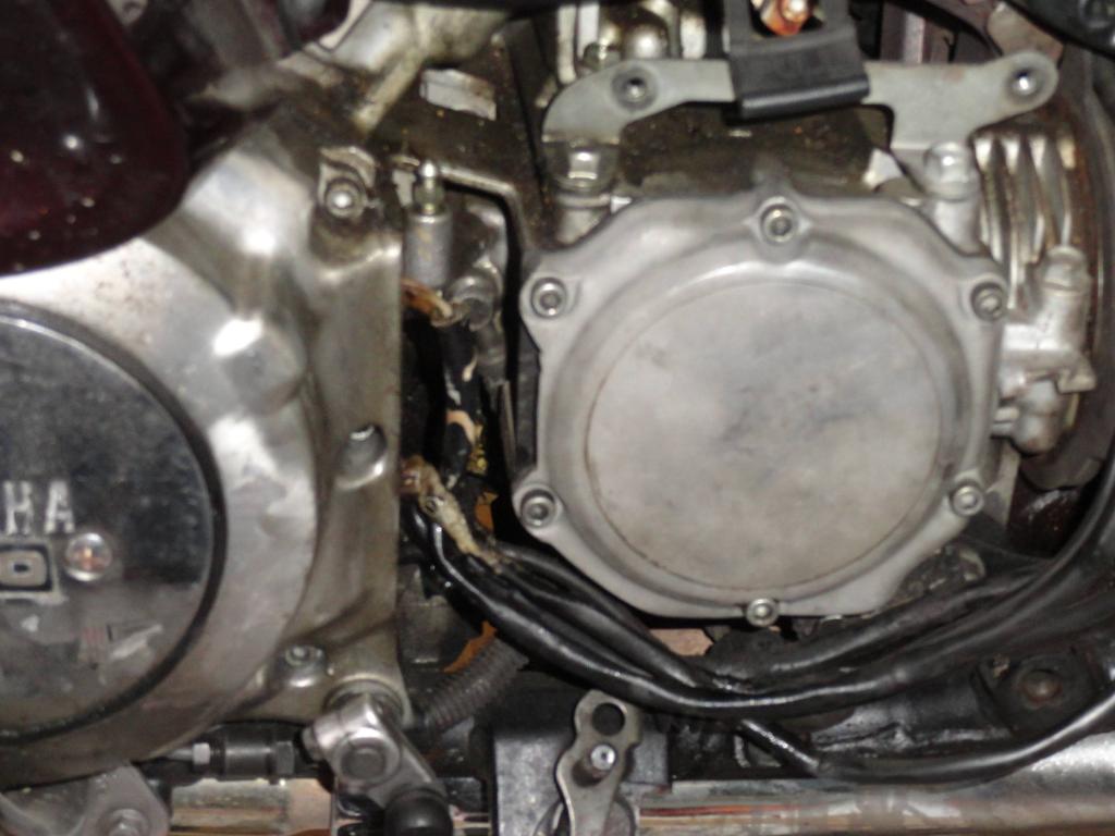

A couple of weeks ago, I started to notice that my 89 had started to mark it's territory with engine oil on the garage floor, and it looked like it was under the middle gear cover (the usual spot). Yesterday Barb and I went for a ride, and when we got home, I put it on the center stand with newspaper under it. I pulled the left side cover off and ran it for a few minutes, and it left a spot on the paper, but I really couldn't see any fresh oil anywhere. I pulled the rubber cover over the clutch slave cylinder and looked down, the stator and the ignition pickup coil wires looked dry. I looked up from the bottom, and couldn't see anything wet. I pulled the left rider's foot peg and looked inside the universal joint rubber cover, and everything looked dry inside ( I replaced the seal here a couple of years ago when I had to replace the universal joint).
This morning I took the next step. I've got a middle gear cover that has all the 'uneeded' material removed so only the middle gear bearing is covered. I located it and installed it. I also checked the clutch slave cylinder (dry), the screws that hold the neutral light/gear indicator switch to the case (snug) the shift shaft (dry) and the stator and ignition pickup coil wiring (dry). I started the bike and ran it until it warmed up. I know that the engine oil wasn't hot yet, but it should have been warm enough to leak. I held the RPMs up for a bit, and also put it in gear and turned over the rear wheel. NOTHING. I looked at the gasket that was on the middle gear cover. It split when I pulled the original cover, but I could see no evidence of fresh oil. Yesterday I did see some fresh oil in the frame under the middle gear, but couldn't tell where it came from. Also I looked over the rear valve cover for leaks. I've got some seepage, but no fresh oil.
What am I missing? I suppose I could put the shifter/foot peg back on and take it for a ride.
On the 2nd picture, you can see the marks on the exhaust pipe that show evidence of the dripping oil.DSC04617a.jpgDSC04617a.jpgDSC04618a.jpg

You've got some cleaning to do before you have a hope of tracing it. Get all that oily grime off the top of the engine and in the area of the clutch slave. Looks like the cylinders might be coated too.
It could be leaking at the stator cover (wires won't necessarily look wet). It's also possible (likely even) that the rear valve cover is leaking and running down the heads and cylinder then finding its way around to the bottom of the engine.

I'm pretty sure that my copper washer is fine. I hadn't disturbed the bottom bolt for several years and I had no leaks from there. I've got the same washer on the down sized middle gear cover now and it's not leaking. Besides the leak is towards the center of the bike a couple of inches from the bottom bolt and also a little foward, or just in front of where the center stand hits the ground when it's used. Actually the leaked oil hit the ground just in front of the center stand left foot.
But I agree, it's pretty crudded up, so I gave the area a de-greasing. Then I put on the front left foot peg and shifter and took it for a 10 mile trip mostly at 65mph. I got home and put it in the shop of the center stand, and when I looked things over, everything was dry and I had no drips on the floor. For a little bit I thought I had the ignition pickup coil leads leaking, but I cleaned that area a little better and ran it for a while at 3500 rpm.......it was only trapped old oil, not fresh. The rear valve cover isn't dripping down the cylinders. The only thing I can think of to do is to leave the cut middle gear cover on the bike and just ride it for a bit. The bike will be down for a few days this week because I'm getting the seat recovered by a local guy.
If I really don't still have a leak, it sure points to the middle gear cover gasket. I've got the temporary cover on with an used old gasket, and things look dry after my ride. If anybody has any ideas, I'd like to hear them.
