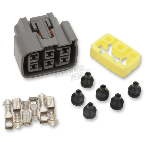

sho_greg Posted February 24, 2016 #20 Posted February 24, 2016 I replaced with a Ricks HO stator and Voltage regulator.. Didn't really check anything before replacing.. Just knew I was only getting about 12.5 volts at the battery. Never had a dead battery but always worried me... While doing the install I found most of my problem... Burnt up wires and partially melted stator connection. I'm still waiting on a replacement for the connector- I found a source at http://www.rmstator.com $9 shipped for free out of New Hampshire?? The real reason for my post was to let you know about a place to buy the stator on ebay- Typically $159... Got it for $110 shipped free. (LionParts) http://www.ebay.com/itm/321838603752?_trksid=p2057872.m2749.l2649&ssPageName=STRK%3AMEBIDX%3AIT http://i15.photobucket.com/albums/a397/sho_greg/20160219_125308.jpg http://i15.photobucket.com/albums/a397/sho_greg/20160220_101310.jpg http://i15.photobucket.com/albums/a397/sho_greg/20160202_121433.jpg
etcswjoe Posted February 24, 2016 #21 Posted February 24, 2016 sho_greg said: I replaced with a Ricks HO stator and Voltage regulator.. Didn't really check anything before replacing.. Just knew I was only getting about 12.5 volts at the battery. Never had a dead battery but always worried me... While doing the install I found most of my problem... Burnt up wires and partially melted stator connection. I'm still waiting on a replacement for the connector- I found a source at http://www.rmstator.com $9 shipped for free out of New Hampshire?? The real reason for my post was to let you know about a place to buy the stator on ebay- Typically $159... Got it for $110 shipped free. (LionParts) http://www.ebay.com/itm/321838603752?_trksid=p2057872.m2749.l2649&ssPageName=STRK%3AMEBIDX%3AIT http://i15.photobucket.com/albums/a397/sho_greg/20160219_125308.jpg http://i15.photobucket.com/albums/a397/sho_greg/20160220_101310.jpg http://i15.photobucket.com/albums/a397/sho_greg/20160202_121433.jpg Thanks for the info, I just bought two connectors one directly from Rick's motorsports after I screwed up the one I bought from Dennis Kirk.
sho_greg Posted February 24, 2016 #22 Posted February 24, 2016 I think Ricks wanted $23 plus shipping.. so the $9 one made me happy... seems like shipping is pretty fast as well.
etcswjoe Posted February 24, 2016 #23 Posted February 24, 2016 sho_greg said: I think Ricks wanted $23 plus shipping.. so the $9 one made me happy... seems like shipping is pretty fast as well. I think I got it on sale and Rick's gave me a big break on the replacement one. Be careful when you crimp the pins that is what I messed up on.
sho_greg Posted February 25, 2016 #24 Posted February 25, 2016 Just tried to crimp and I don't know how to crimp these uninsulated pieces.. Weird.. So I am using a pair of pliers.. I did buy a new ratchet style crimper off of amazon and it should be here Friday but I don't want to wait..
etcswjoe Posted February 25, 2016 #25 Posted February 25, 2016 I borrowed one and the lugs are a little small for the wires so I ended up using pliers to finish it.
