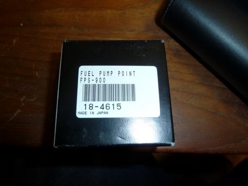

Condor Posted February 17, 2015 Posted February 17, 2015 If it were the kill switch the bike wouldn't crank. Same with the kickstand cut-off. Looking at other possibilities. I'm still thinking it is the pump...and like you mentioned the points could be worn out (there is a kit recommended that replaces the points). Intermittent issues are fun.... start with the inexpensive, easy to verify possibilities. Very true...forgot about that. Pump could be a possibility, but if it clicks 99 times out of a 100 it's OK. The part number for the point kit is
Wesley G Posted February 17, 2015 Author Posted February 17, 2015 Yeah I figured if it was the kill switch then it wouldn't turn over at all. I just went for a short ride to the beer store and came back 5 minutes later and it acted like it didn't want to start again. This time I put it in neutral and it fired right up. I also turned the fuel off 1/2 mile from the house to drain the bowls. When I turned the key back on it clicked much more than usual so who knows... I just gotta figure this out cause I'm going from Mississippi to Colorado (1500 miles each way) and I sure would hate to be stranded... Thanks for all the help and hopefully I can start troubleshooting as soon as I get some time.
