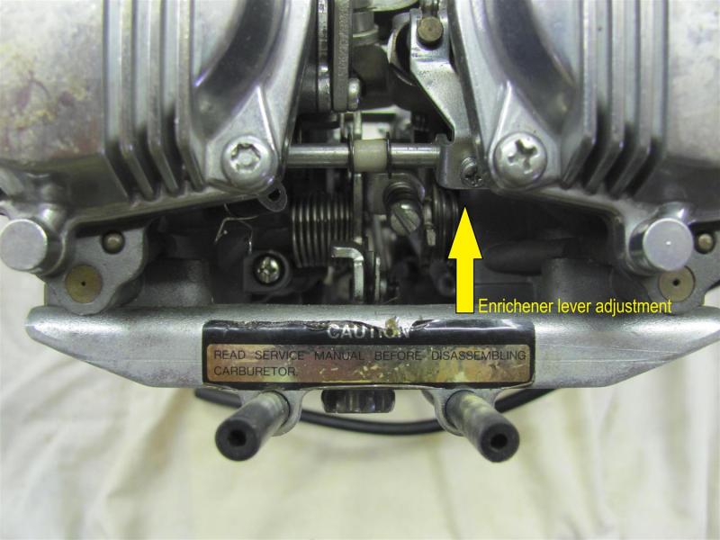

Prairiehammer Posted December 10, 2014 #6 Posted December 10, 2014 In addition to checking for full enrichener opening by the cable adjustment Pete mentions, also check that all four enricheners are fully opening. Sometimes one or more of the enricheners are maladjusted. The individual enricheners may not all be fully opening when the 'choke' lever is fully rotated to 'choke'. Check that each enrichener actuating lever is adjusted correctly. The enrichener actuating levers are clamped to the common actuator bar with set screws. Check each for correct travel adjustment and for all the set screws to be secure.
