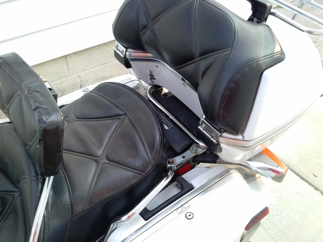

Well after the input I went to Home Depot and got some flat bar and bolts and stuff. Well it ain't pretty, lol, but not bad for a musician. The test well be when my wife gets home but my mom is a little bigger. The good news is my real biker babe is my daughter (6 yrs old) can still set with me and not falling out the back. She is my primary rider but this setup is not to hard to take off
Thanks again for the help!!!
Big C

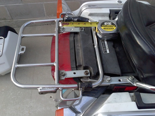

When I get a moment, I'll snap a pic of my '83 that I moved the trunk back. I used 2 angle brackets (5 x 5 x 1.125, 1/8 thk, Menards, less than $2 each) that I cut at the angle, they already had holes and it moved the rack back about 2 1/2". It moves the whole rack back, as the trunk is removable. Went on a 400+ miles ride with the wife (her first time on it) and not an issue.

So I took a few pics of my relocated trunk, it actually moves the rack back 3 1/4". The brackets were narrow enough that they fit into the rack mounts w/o any shims, and all the holes were drilled, and evenly spaced, so I didn't have to measure or drill, just cut and bolt on. All I had to do was find 4 nuts & bolts, which I have a bunch from dis-assembling my parts bike. As for the plastic cover, I don't have CLASS (PO removed it) so I just trimmed the plastic away where the bar would be, I'll probably find a piece of sheet metal and make a nicer cover that sits down further so it'll look nice if I run w/o the trunk. I left the plastic on because there is a hole otherwise, and it shows the taillight wires.
