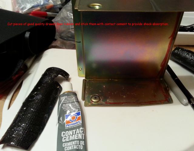

mbrood Posted February 16, 2014 #8 Posted February 16, 2014 It's been reported quite often, audio intermittents, power blinks... the two. lower receiver connections, after years of tuner/cassette rack removal and reinstall, tend to flex down on install resulting in a poor connection. I put a couple small washers between the lower connections and the tray to raise the connectors up a bit and now the "seating" of the radio rack is solid and tight. Mike

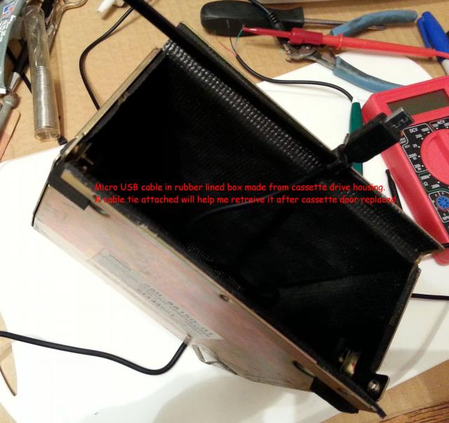

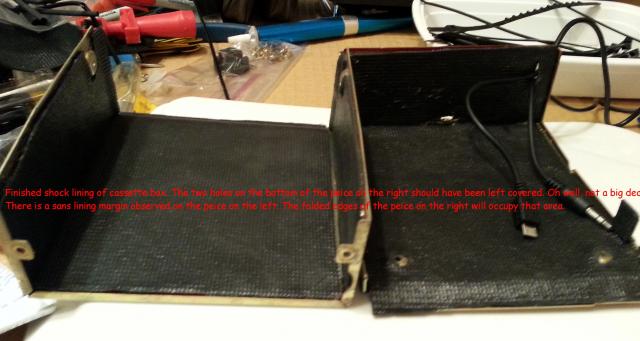

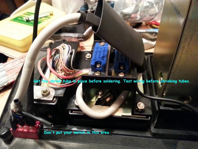

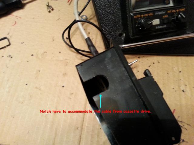

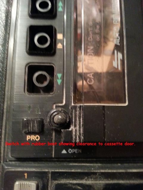

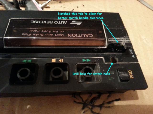

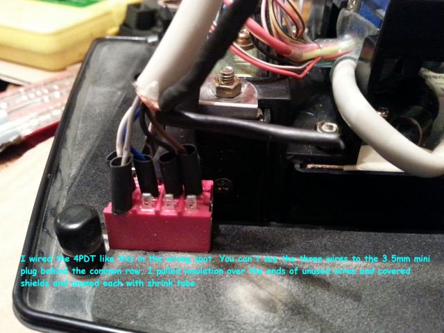

syscrusher Posted February 18, 2014 Author #9 Posted February 18, 2014 (edited) Amico AC 250V 2A 125V 6A on/off/on 4PDT Toggle Switch with Waterproof Boot On Amazon: Amico%20AC%20250V%202A%20125V%206A%20on/off/on%204PDT%20Toggle%20Switch%20with%20Waterproof%20Boot%20-%20Amazon.com@@AMEPARAM@@http://ecx.images-amazon.com/images/I/41U3K5xeMRL.@@AMEPARAM@@41U3K5xeMRL"]4PDT The rest of it (USB charger) is just the kind that plugs into your 12v cig lighter socket. I opened it and soldered in wires to connect to the ACC fuse. I decided that I may use standard cables under the top assembly from the USB to BT RCVR and from BT into wiring harness. The BT RCVR works well while on charger so that's good. If I later have connector trouble then I'll hardwire stuff. This is assuming that I get the 24 pin connectors sorted out. So far I have about $25 spent. I recommend this BT RCVR , it will operate while connected to a charger and has buttons on the side that let you go forward to the next track or back to the previous one. Edited April 16, 2016 by syscrusher Updated

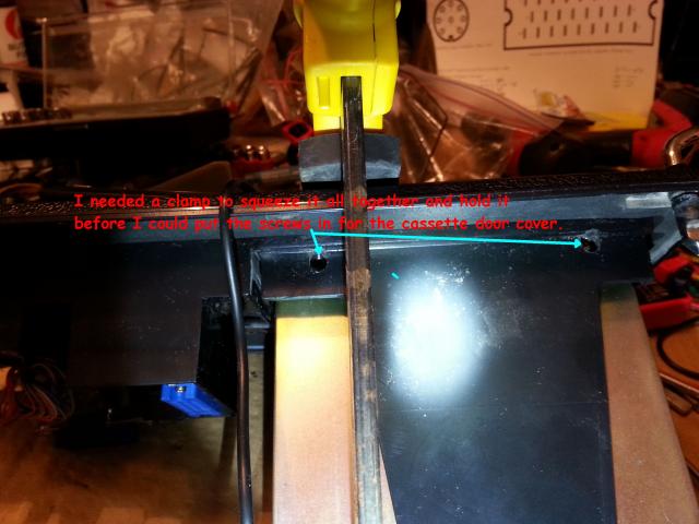

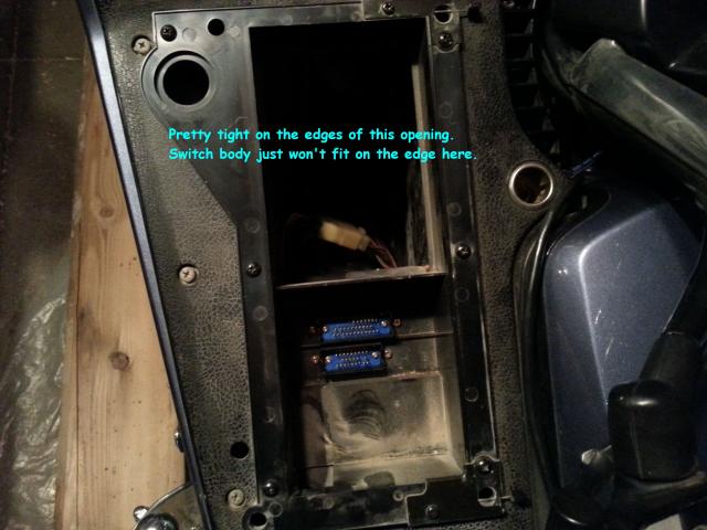

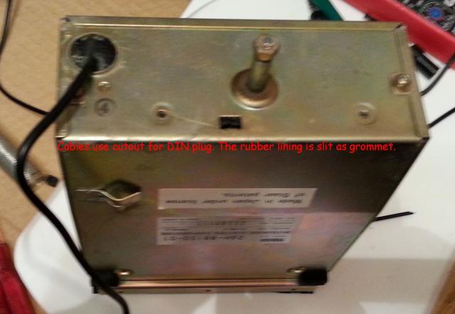

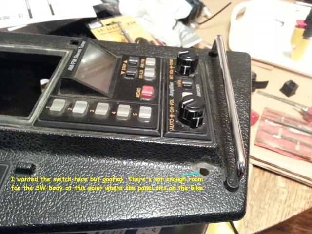

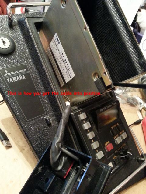

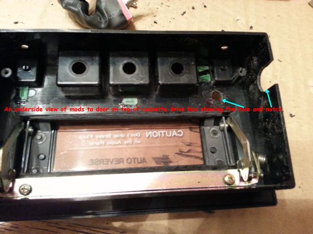

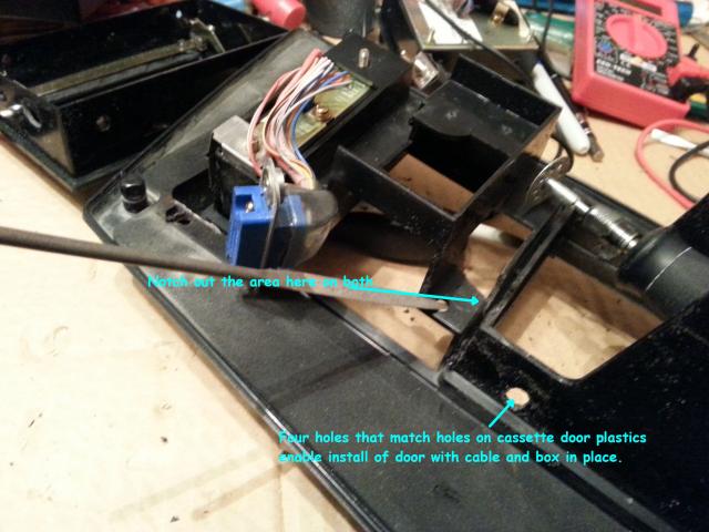

syscrusher Posted February 25, 2014 Author #10 Posted February 25, 2014 (edited) Here's a few more photos for your enjoyment. BTW, I realize now that the 4PDT switch is a waste but I'm using it anyway because it has the rubber boot and I may use some other optioning on it. I am not sure that the 12v to the cassette is going to have the load capability for my USB charging port so I'll probably wire that into the bike and use unplugging the USB cable itself to enable the removal of the radio section from the rest of the bike. The draw back will be that I will have to power up the BT manually when I start the bike rather than have it start with the key. Later I may rethink this, I'd really like it to work more automagically. Edited February 5, 2016 by Freebird pics
syscrusher Posted March 2, 2014 Author #11 Posted March 2, 2014 (edited) I'll add more info later. So far it still seems to be wired correctly, no opens or shorts. Edited February 5, 2016 by Freebird

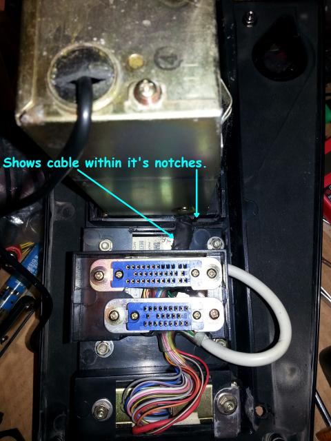

syscrusher Posted March 2, 2014 Author #12 Posted March 2, 2014 (edited) Final assembly details. Edited February 5, 2016 by Freebird
Prairiehammer Posted March 2, 2014 #13 Posted March 2, 2014 Remember what I said could have been your original problem of intermittent audio operation? On the pic of "My pins", notice the third pin down on the right hand row in the right connector? It appears to be recessed into the connector body. Prolly want to fix that. That pin may not be doing anything now with your new set-up, then again...
syscrusher Posted March 2, 2014 Author #14 Posted March 2, 2014 (edited) Prairiehammer said: Remember what I said could have been your original problem of intermittent audio operation? On the pic of "My pins", notice the third pin down on the right hand row in the right connector? It appears to be recessed into the connector body. Prolly want to fix that. That pin may not be doing anything now with your new set-up, then again... Good eye! No wonder you can guess all of those motorbikes, you've got an eye for detail. I thought for a second that it was the left audio pin itself (pin 5), but I guess it's an unknown pin. I'll fix it and we'll see what happens. Thanks! Edited March 2, 2014 by syscrusher wrong pin

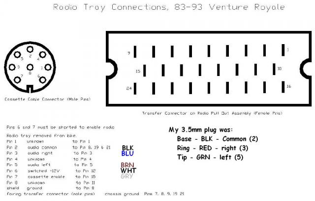

syscrusher Posted March 2, 2014 Author #15 Posted March 2, 2014 (edited) I modified this document that another member developed in order to show how I had wired my switch, plug, and cables. I would like it to be available full size but I am not sure how to do that. Any help with that? It was documented in another article that the cassette inputs are active when the connection between pins 6 & 7 of cassette cable are open so I used the fourth pole of my switch (4PDT) and wired the 12v signal to the common and "cassette enable" to the corresponding pin on the opposite bank from those used for my 3.5mm plug. It's 35 degrees out so I'm going to chuck it into the bike and see if it works. Edited February 5, 2016 by Freebird

syscrusher Posted March 4, 2014 Author #17 Posted March 4, 2014 OK, so it was 35 today and the mods work just fine except the washers I put under the blue connectors seem a little too thick and need to come back out. I also need to really get at the connector that is on the bike side in the radio mounting to fix that pin that pushes in. Does anyone know how much stuff has to come out before I can get those connectors free of the bike? Also does anyone know where to find a pinout of the large Molex connector just under the radio mount in the left side of the fairing? As always, thanks in advance for your help.
