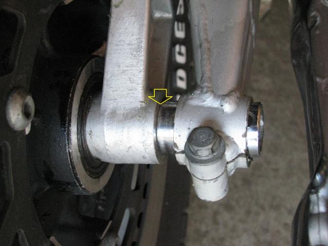

SpencerPJ Posted September 27, 2013 Posted September 27, 2013 (edited) So, I replaced my tires the other day, went with the original Bridgestone Spitfires. However, I was noticing, that it seems that the local shop left off a washer, so I think. I just remember the axel sticking out so I could see the complete hole, see pic. I've looked at the parts breakdown and not sure what side of the brake caliber bracket the washer goes on. I've attached a picture of what I have, hoping someone might let me know if they see a problem. It seems to ride great, has a very slight vibration at 45mph, probably didn't balance perfect. hoping it goes away after broken in. thanks Edited January 21, 2018 by Freebird

Squidley Posted September 28, 2013 Posted September 28, 2013 Paul, It looks to me like you may have other issues as well. Make sure that you have the bearing spacer in the rim (pics below) your pic doesn't show it really well, and compared to the pics of my '83 it looks like the caliper arm is about the same distance out. So it may be there, but check that out. Your definitely missing the washer, which is a buffer between the aluminum caliper bar and the steel axle shaft so it doesn't dig into the aluminum and deform it. It also allows level surface pressure to press all of it together squarely on the rear wheel bearing. Personally this is why I never let anyone work on my bikes, way too many hacks out there that think they are mechanics. If you decide to do this yourself, it's not a huge deal. You'll need to take off the right muffler to pull the axle out, which you dont need to pull it out all the way. Slide the new washer between the swing arm and the caliper bracket and slide the axle shaft back in. Tighten the 12mm pinch bolt up, torque the castle nut to 110 ft lbs and cotter pin it again. Loosen the 12mm pinch bolt up so the swing arm will come back to it's neutral position and tighten that back down.

SpencerPJ Posted September 30, 2013 Author Posted September 30, 2013 (edited) Hi Guys, I know I said I had that bearing spacer between the brake arm and wheel, and I still think I do, and I was going to order the washer (#27) I'm definitely missing, but could you double check the attached picture and see if you agree that the green arrow points to the bearing spacer (#4). Edited September 30, 2013 by SpencerPJ
Squidley Posted October 1, 2013 Posted October 1, 2013 Hi Guys, I know I said I had that bearing spacer between the brake arm and wheel, and I still think I do, and I was going to order the washer (#27) I'm definitely missing, but could you double check the attached picture and see if you agree that the green arrow points to the bearing spacer (#4). Paul, With the pic you have up it does look like you DO have the spacer on the rim, so you dont have to order #4, just the washer....
