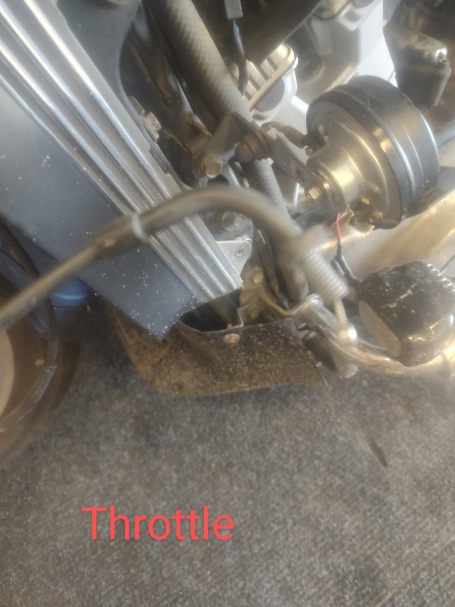

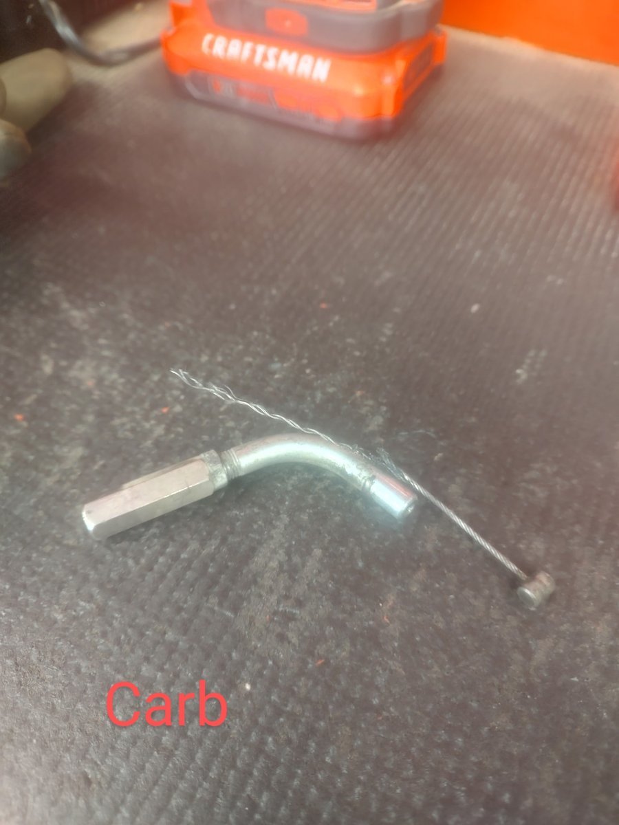

Hi Rick, many thanks for the info on Sport Wheel, I'm definitely gonna have to check this place out! The eBay link shows the wrong cable for my bike; while the handlebar end looks correct, it doesn't have this metal piece on carb end. I'm wondering if we have the wrong p/n? It needs the 2 ends shown in the pics attached. If anyone can help me out with p/n I appreciate it! It's a 1988 Venture Royal 1300. See all pics attached. - Yesterday

Hi John, He is one on ebay that claims to be open but unused and has all you want. https://www.ebay.com/p/1322895779, if that doesnt work and you dont mind getting dirty, Sport Wheel in Jordan Minnesota have a number of used Ventures on site and you could remove the needed cable your self and maybe cable 1 as insurance also. They have a number of parts on the bikes and they are 83-93 Ventures. Sport Wheel is on Hwy 169 between Jordan and Shakopee Minn. https://www.sportwheel.com/ Let me know if you have any question. Rick F. -

Hi all, in July I rode through Bear Tooth Pass, AMAZING! Literally the day I got back home to Minnesota, my throttle cable broke! Whew, that was lucky. My local repair guy found the p/n on the oem diagram, it lists "41V-26312-00-00 Cable 2 (pull cable)". He ordered a new cable from Ebay with this p/n, but now that he's doing the repair, he found the cable doesn't come with the adjuster elbow piece (photo attached). And the new cable's terminator doesn't fit through the old adjuster elbow; because the terminator is too large to fit through. We can't put it together with what we have. Cable 1 (push) is still available from Yamaha, but Cable 2 (pull) isn't. I don't find the right cable with a web search. Does anyone know where to get this cable with the adjuster piece like the OEM diagram shows??
