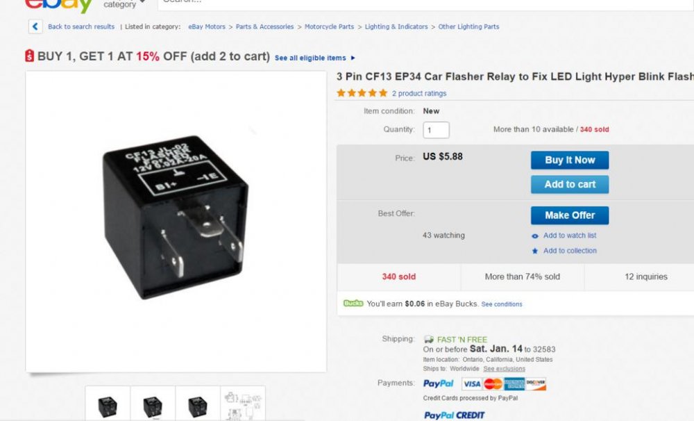

I believe your problem lies within the flasher. The LEDs don't draw enough load to make proper flashing. But you may have gotten lucky... After reviewing the 83 Wiring schematic it appears the the 83 has a stand alone flasher relay. cowpuc or Venturous Randy or one of the of the other notorious 83 riders might know if the the 83 flasher relay is a stand alone. The subsequent model years have an integrated Flasher-relay/Canceling relay/Starting Circuit cutoff relay. There may be other issues as well, but I think the LED flasher might be a good place to start. I'd be interested to see if the LED Flasher helps. You might be able to just swap out the relay to one designed for LEDs http://www.ebay.com/itm/3-Pin-CF13-EP34-Car-Flasher-Relay-to-Fix-LED-Light-Hyper-Blink-Flash-or-No-Flash-/161193691684?hash=item2587e48a24:g:SkcAAOxyXDhSi-t4&vxp=mtr
