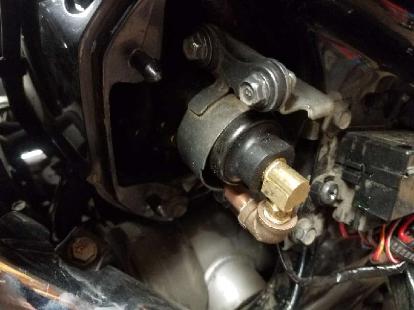

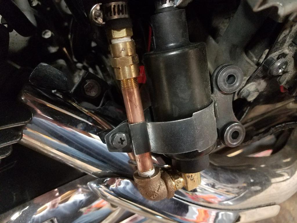

Here's the upgraded version of 40171. https://www.pegasusautoracing.com/productdetails.asp?RecID=7550 I used the MR Gasket 42's that I got at Autozone, So far, So good. There's a writeup in the tech section on how to set it up from "djh3". He used the supplied fuel filter and made a custom mounting bracket. I didn't use the filter and extended the inlet tube tip so it was very close to lining up with the outlet tip. This allowed me to use the stock mounting bracket. I also relocated a new clear fuel filter to under the seat between the gas tank and battery for easier access. Had to pick up some 5/16 fuel line for it. Here's the writeup. https://www.venturerider.org/forum/showthread.php?86265-Mr-Gasket-Fuel-Pump-Conversion -

Hmmm. My biggest concern is the longevity of this pump. It's gotta last longer than the stock one, Right? Am I reading the specs wrong? It's stated that this pump prevents vapor lock. This is the description over at Summit Racing: Brand: Mr. Gasket Manufacturer's Part Number: 42S Part Type: Fuel Pumps, Electric External Product Line: Mr. Gasket Micro Electronic Fuel Pumps Summit Racing Part Number: MRG-42S UPC: 084041996287 Free Flow Rate: 42 gph/159 lph Maximum Pressure (psi): 2 to 3.5 psi Inlet Size: 1/8 in. NPT Inlet Quantity: One Inlet Attachment: Female threads Outlet Size: 1/8 in. NPT Outlet Quantity: One Outlet Attachment: Female threads Quantity: Sold individually. In-Store Pickup: Choose In-store pick-up (OH, NV, GA, TX) on our web site. These Mr. Gasket micro electronic fuel pumps are compatible with gasoline or diesel (depending on the application) based fuels and additives. They feature solid-state, worry-free electronics and eliminate vapor lock and flooding. Mr. Gasket micro electronic fuel pumps are great as stand-alone or booster pumps, are self-priming, and have a simple 2-wire design. They work with 12 V negative-ground systems and include mounting hardware. Mr. Gasket micro electronic fuel pumps will supply adequate fuel, time and time again. I was able to use the stock clamp because I didn't use the filter that came with the pump (have one under the driver seat just behind the tank) and used a 3" brass nipple with a union and fuel line fitting so the tips of both fuel nipple are almost even. The stock clamp fits tightly even though you see gaps in the pics I am posting and gap in the clamp for the black plastic extension on the stock pump clamps very nicely on the brass fuel pipe I put on the mister gasket. I did this because I am going to replace the points on the stock pump and use it as a spare and wanted it to be plug and play. For part of the plug and play, instead of splicing the stock pump connector onto the MR Gasket, I cut the 2 pin clip off the old pump and soldered on waterproof 2 female pin connectors on to it. (like old hondas and such used)The plugged it back into the the one on the bike. Then I soldered on the waterproof male pins onto the wires of the stock pump and Mr Gasket pump so that either one can plug into the female pin connectors that are on the stock 2 pin connector.
