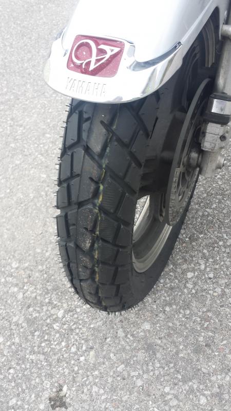

im running a pirelli scorpion in the front and a TW 40 in the rear. TW40 and the TW202 are the only knobbies for our first gens rear tire also do your frame a favor and give everything a healthy coat of ACF 50
