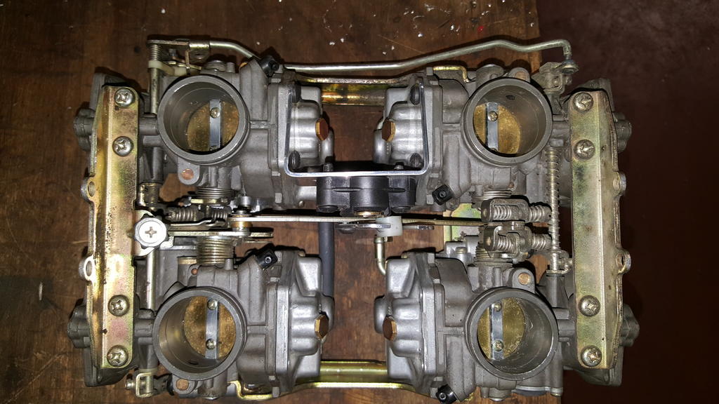

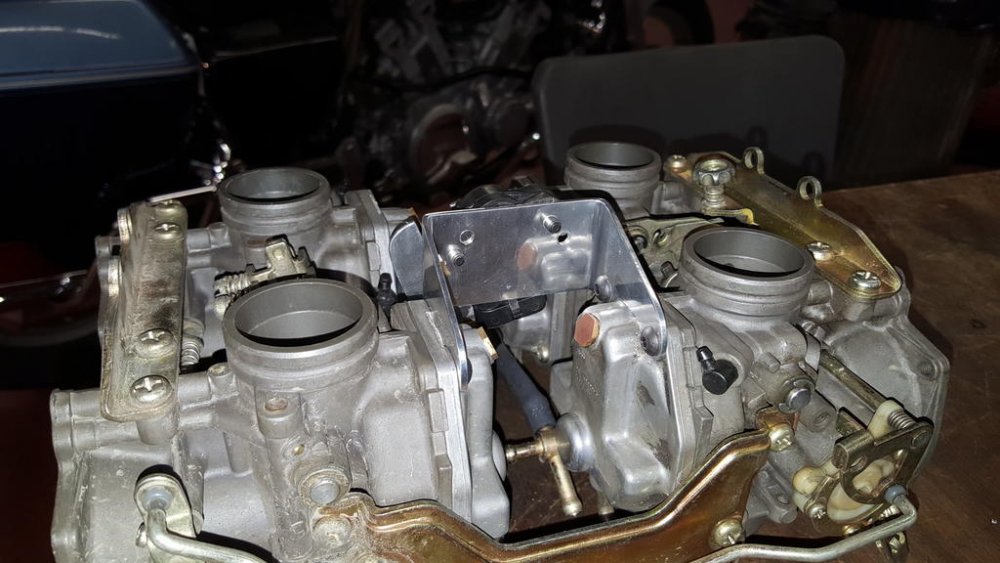

those arent the carbs in the bike, they are just a set i pulled off the shelf at random to set up the tps before i pulled the ones in the bike. i will swap the flywheel and the bikes harness if the 4 coil is better i just want to make sure im setting it up with the best gear for when i do the vmax top end conversion -

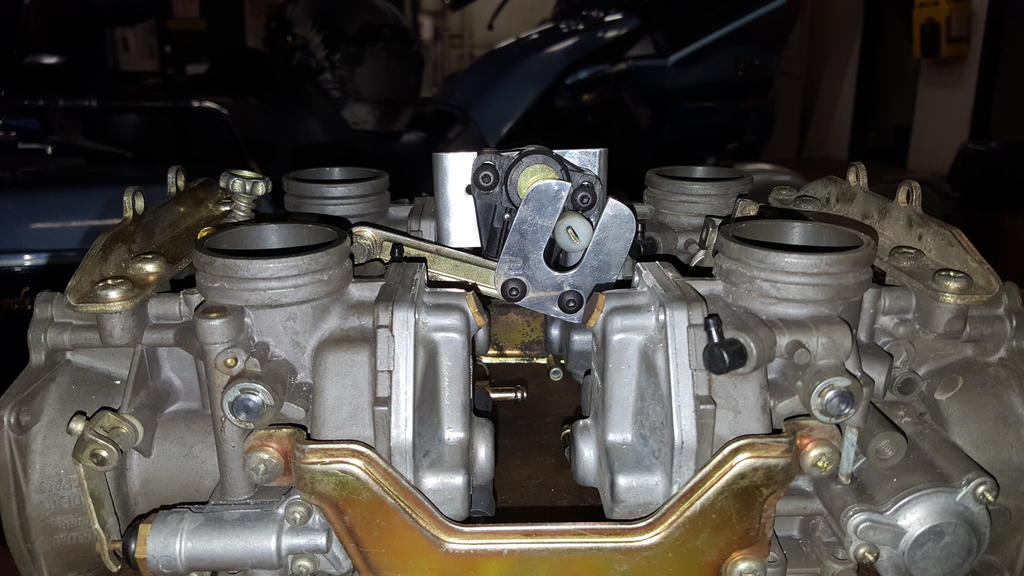

i got my tps and will post how i got it mounted into the carb rack tomorrow, but will have to test my coil tonight as i think its gone bad since the ignitech is picking it up so far out of position EDIT: so i tested my pick up and it read in 97 - 98 ohms so a bit low. and the tps is now mounted so since it seems i will need a new pick up, which is better the single or four coil pick up? -

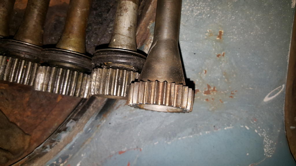

there are so many of those things laying around repair is just not really worth it but if its required welding and resplining is the only way to go -
Drive shaft and such
Black wing replied to dna9656's topic in Venture and Venture Royale Tech Talk ('83 - '93)
ive got about 20 of those laying around, pm your adress and pay shipping and i'll send ya one. -

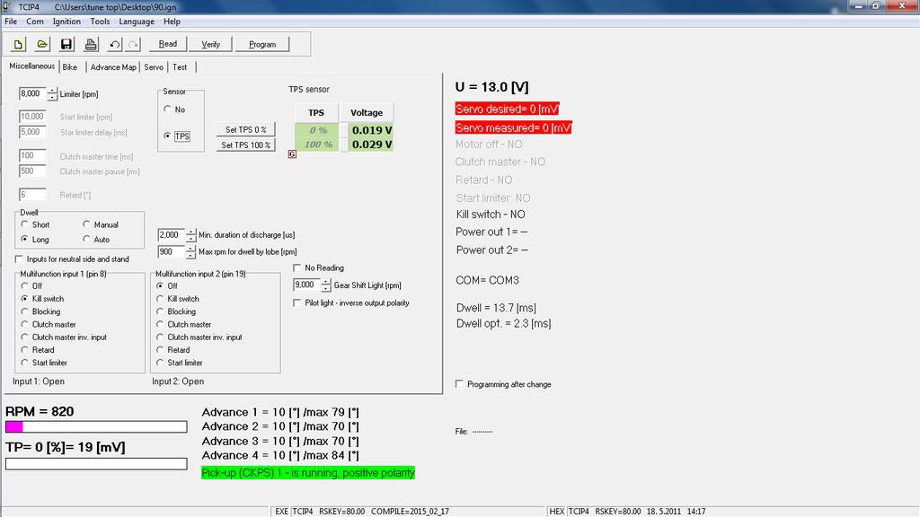

now that is a good idea, i guess i'll head to the parts shop tomorrow. any idea which tps works best with this system? EDIT: this one looks like i could mount it directly to the carb rack http://www.highwaystars.net/sensor-throttle-position-acdelco/ -

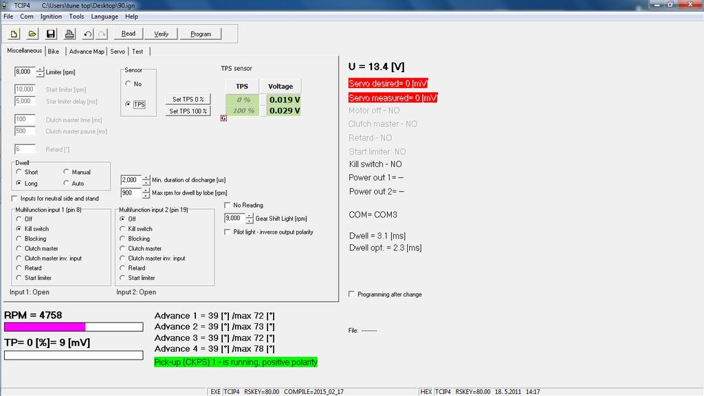

yeah its got the map sensor on it but im not getting a read from it when its running EDIT: so while watching the tps i figured out where the reading issue is. the voltage reads back wards to a real tps. so closed throttle is .019v and full is .009, but the v80 software wont let me set a smaller value as the 100% 0% 100% -

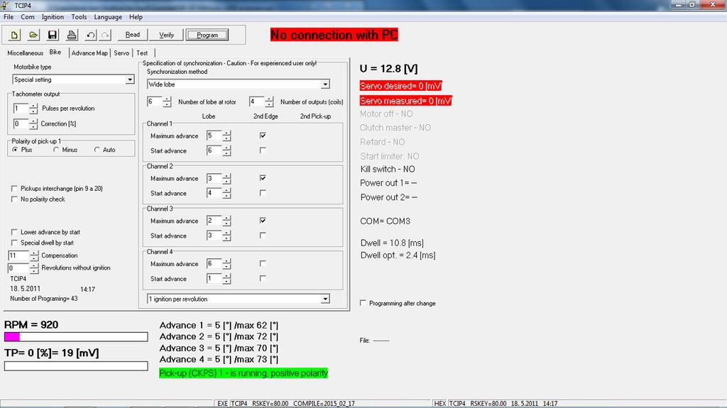

so im trying to hook my ignitech up to my new bike. i have re configured the plugs to run the 90-93 set up, using the up to date v80 software i can not get it to fire properly using either the old map set up or the new one(i copied it from the v88 software map). i could get it to run really rough for a few seconds but it sounds like its not picking the crank position properly. any one got any ideas? or if someone is in the edmonton area running a v80 on a 90s bike want to meet up and swap computers for a sec so i can verify mine is even working? EDIT: i got the bike to run by moving the channel advance up one position across the board, but it still runs like crap the tps is not recognizing movement at any rpm. it sounds like atleast one cylinder is not firing.
