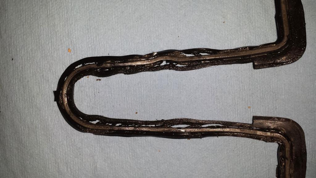

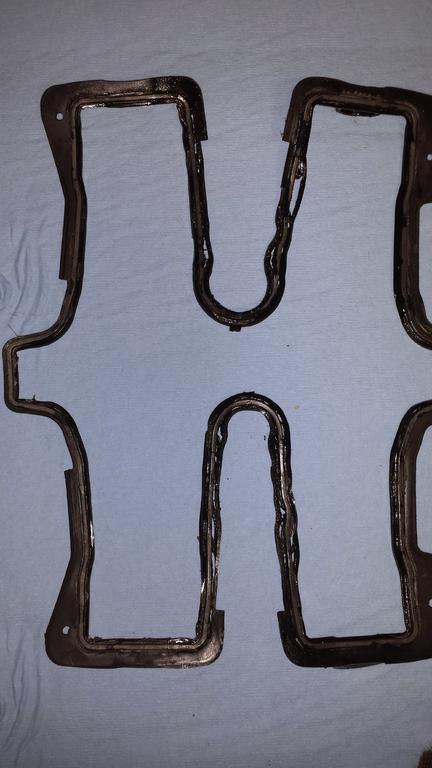

  9. Update, I think I found the problem with my gasket. I used orginal yamaha part. I did not want to buy the bolt grommets, just to pricey,$9 ea.( I can't under stand why they are so high, the ones for my previous GoldWing were only about $3 ea. and still are. Used a suggestion from Tech section about using washer. Just checked I have a thinner washer on the 1-3 covers, the ones on the 2-4 are twice as thick! Therefore, I created the problem!! Going to do some research to seeing if I can find a better price on the grommets. Thinks for all the input,
  10. Removed valve cover cyl 2&4, leaking. Had replaced once before around 50,000 miles, now have 98,000. Was leaking into spark plug area. The gasket had splits in it. Almost looks like it melted. Has anyone seen this before? Pixs attached. Is their something I need to check before replacing?
