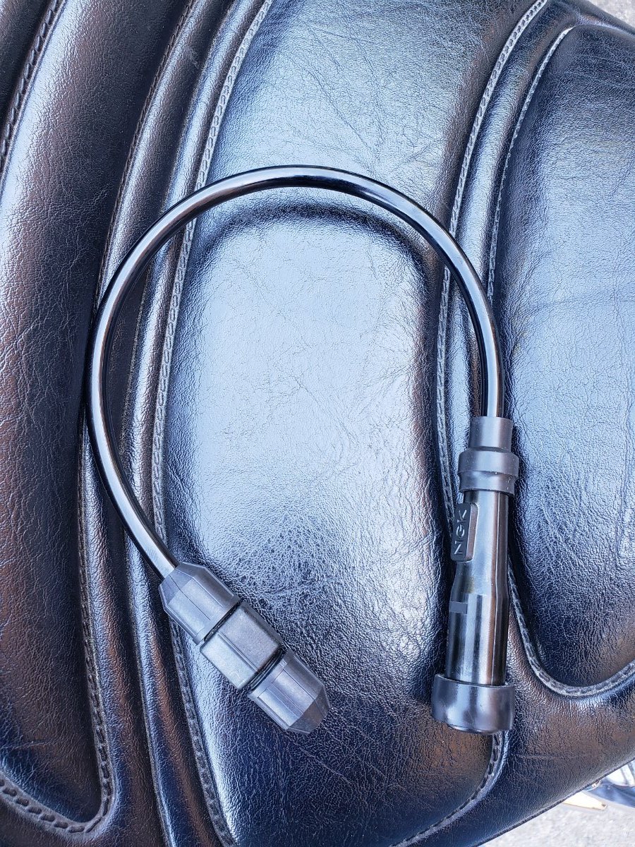

	I would be looking at plug boots/caps before coils, but weak coils is a possibility. I've been experiencing a missing/stumbling under load, and I traced some of the problem back to bad factory plug caps. I replaced the ones in cylinders #1 & #2 with new NGK SD05F, and the situation improved drastically. Managed to replace #4 as well, but the factory plug wire on #3 is too short to do the swap. I had to order a bit of 7mm wire and a NGK J1 plug wire splicer. Hopefully I'll have a chance to install it this afternoon.
