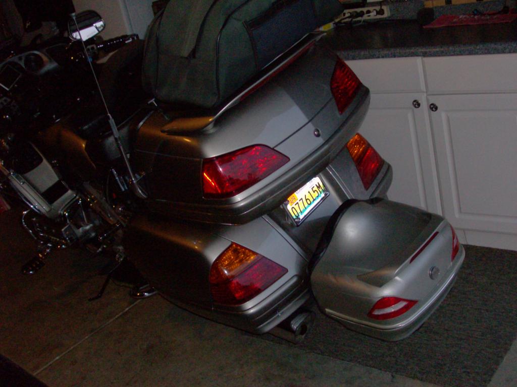

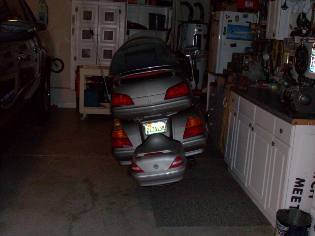

  12. Back up lights...NOT!!!.....I blocked the clear part off with hi-vis aluminum foil. No lighting will show thru the clear area. Only thru the red area of lens. I just finished installing stop lights in the spoiler..I'm done.. Just going to use it as is for a while to see if I really like it and if so, I am going to take it all apart again and match paint it to the wing... [/font] No need for heat shields @BigLenny... I rode over a hundred miles the other day and the trunk didn't even get hot..

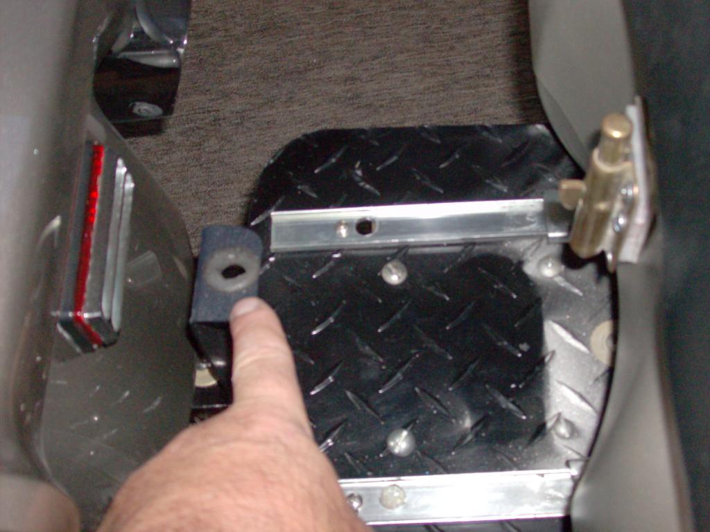

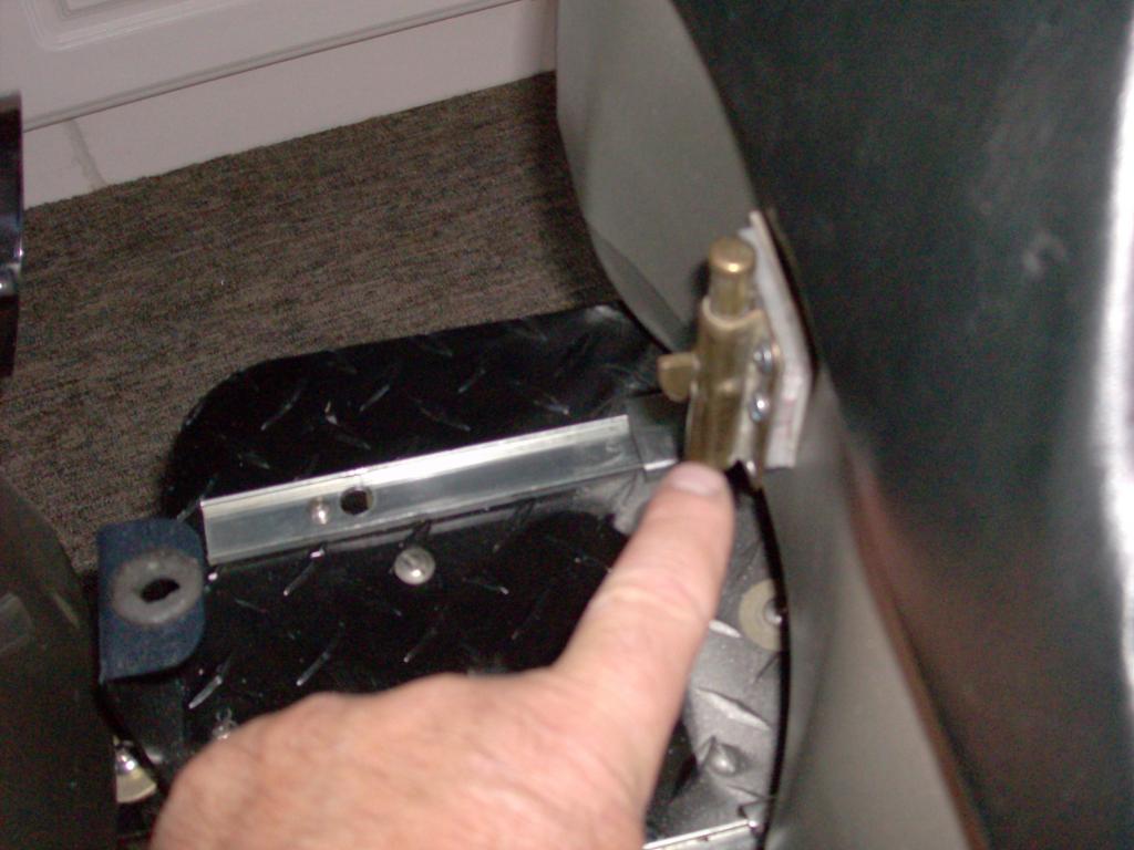

  14. Added (4) running lights to the little trunk today. Got them wired in and ran the wire harness to the bike. They work great. Next, install lights in the spoiler. I added a better picture of the licking mechanism with the brass spring lock and the "Z" bracket I made for clairity.

  16. @Skid , It appears that your trunk opens to the side.?? Any extra space is good for those shorter trips. Even if it is only to store your wet bike cover in..

  21. Well it all started when the trunk was white. Measuring, fitting, making brackets and aligning. Today I spent the day taking everything apart, and painting the trunk silver. No, it does not match the exact color of my 02 wing, but using excess spray cans of paint I have on the shelf I came close to making it similar to the color but anyone can tell it does not match. Who cares...not me.. Here are a few pics of it painted silver and I included a couple pics showing how I made the locking mechanism so it stays in place when moved forward towards the rear of the bike. Pic #2434 shows the barn door spring lock, and pic # 2435 shows the bracket I made using a rubber electrical washer (so it don't rattle), and the lock "shaft" fits inside the rubber washer when locked. When I push on the tab on the lock, it disengages and I can roll the trunk backwards (aft) so that I can open the lid with out touching the rear of the bike. Awe heck ...the pictures are not all that clear.......sorry.. `
