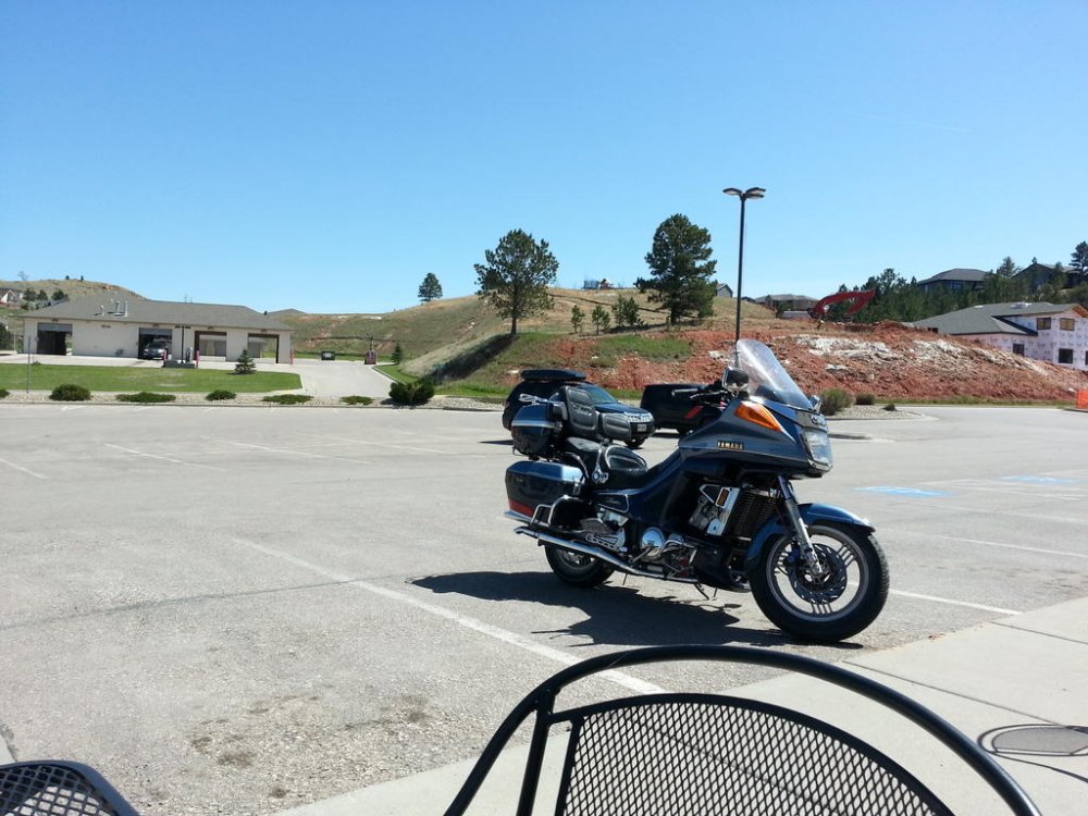

	It couldnt be better, I snugged up the new head bearings a tad and loosened/tightened the tree, braces and front a axle and completely lost the highway wiggle. Tbrew on the carbtune again and set the AF by ear, got from 2.5 turns to about 1-7/8 turns on each carb. It has more pep now so well see if I rise from 30mpg. Im sitting at a coffee shop now before I head out across the badlands of SD. I hope you are all having this sort of day too!
