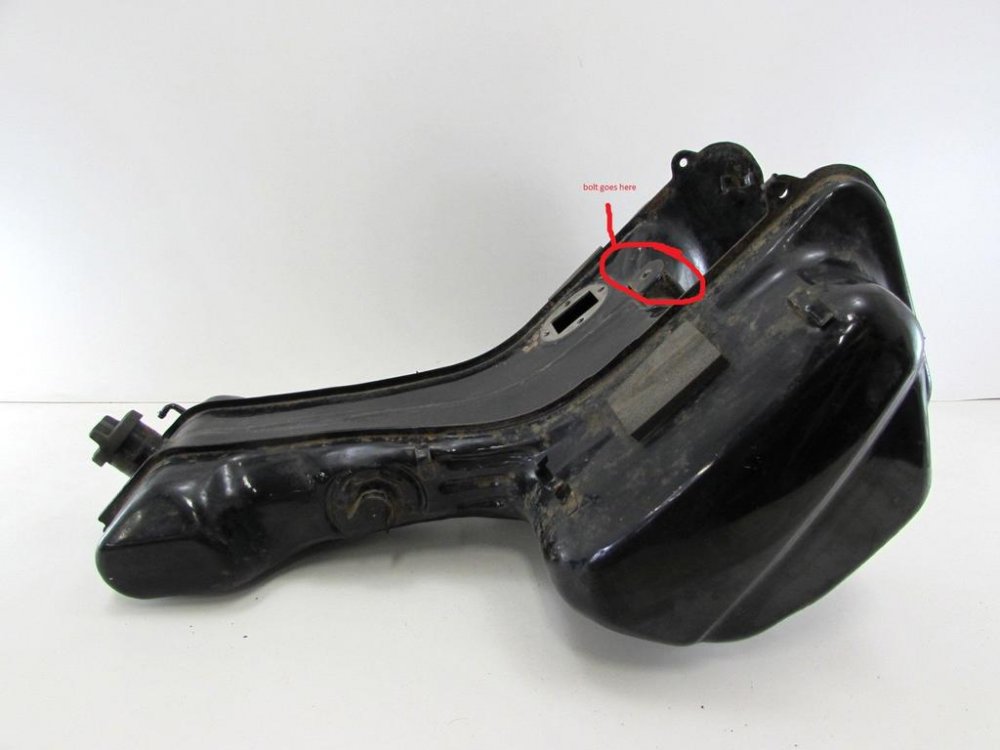

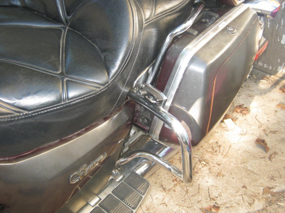

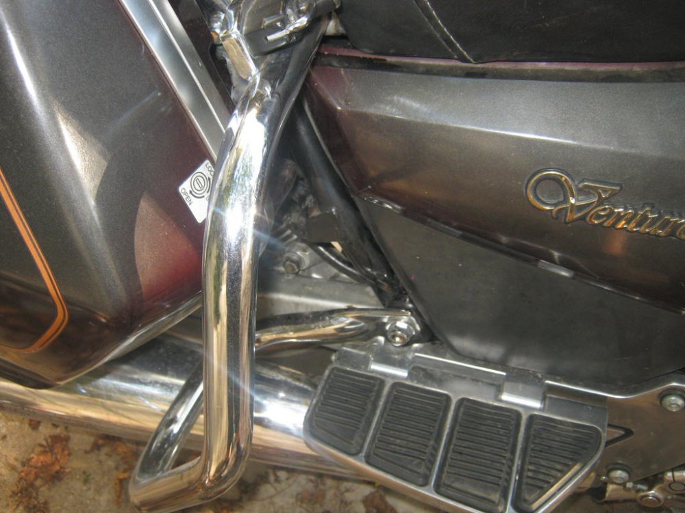

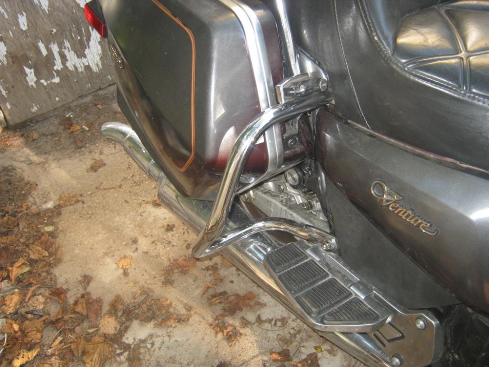

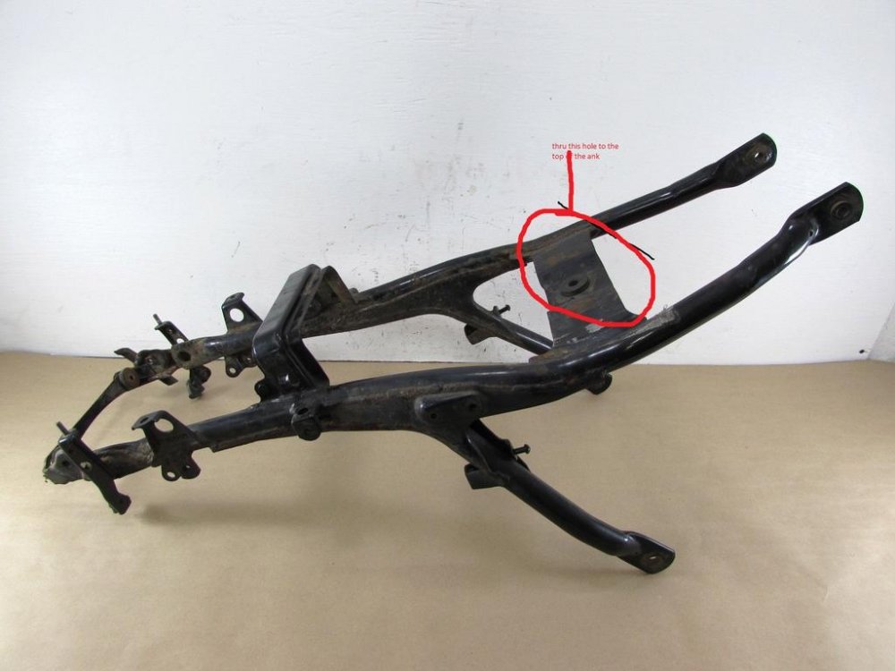

Don't know if this will help you any but here is a picture of the crash bar and subframe I am not sure if yours will be the same or not. Yours is an 86 with updated saddle bags that open from the top. -
				1986 Free the Venture Restoration
snyper316 replied to Asher1877's topic in Venture and Venture Royale Tech Talk ('83 - '93)
Its a long bolt in the center of the subframe I put the gas tank on and put this small bracket over the neck loosely. then I bring up the sub frame and put it up loosely. Then I Put the long bolt in and snug it.. Then I tighten everything else on. Hope this helps you decipher. -
