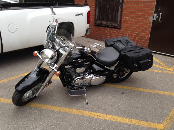

I traded off the 01 venture.89,000 miles, ran ok.It was not maintained at all before I got it.But the clutch was going to need replaced,it had many bad cosmetic problems from being dropped, and all I had was a bonded title.I will try to post a picture of what I got.2009 c50,20,000 miles, 3 years warranty.
