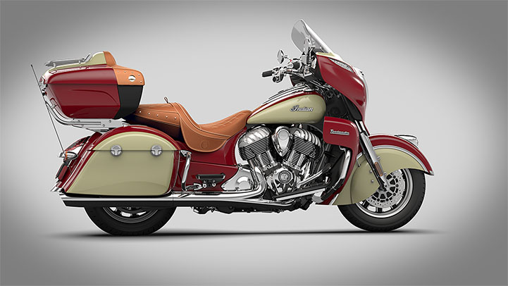

	This is what I would have in my garage if I could afford it.I think it would make a great alternative to the venture.what do you think?
